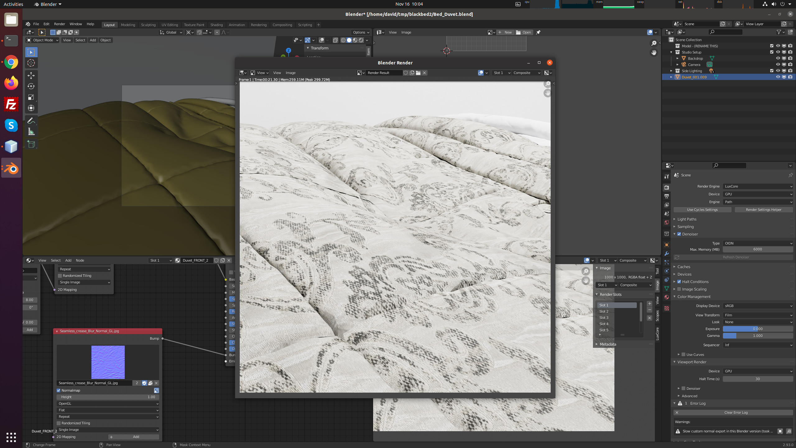

I'm getting this out of the box:
I tested on a RTX 2070 Super and a GTX 980. Are you getting a different result ?
