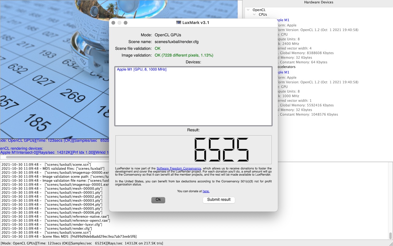

u3dreal wrote: Sun Nov 14, 2021 1:24 pm With the new MacBookPro updates i'm more than tempted to get one ... but ... it's alot of money.
Yeah I was waiting for those one year long but I think for rendering they are not well suited.
With the lack of raytracing cores they won't be able to compete with nVidia's mobile cards but being much pricier.
My old iMac 2009 just died and my MacBook is in no good shape either so I decided not to wait for the Air M2 any longer but got a used Air M1 for the mean time.
First thing to do was installing Blender with LuxCore and it just worked, including 7 GPU cores.
I wonder if Apple will add a raytracing module in the future, seeing how they got involved with Otoy, Maxon and Blender lately.
Those got help from Apple guys adapting their code while indie devs are left to their own devices literally :x

OK the difference is really huge. wonder if a Metal implementation would be faster ?
We will see once cycles has a metal device.
