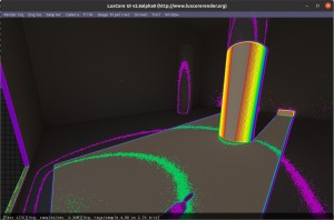

I have been playing around with these values, but since I don't fully understand them, particularly when applied to a sun I am getting something like this: https://bit.ly/2YoGN39

The sun is a LOOOOOT more powerful than artificial light sources so you need to increase the range of the contour plugin by a looooot.
With the following parameters:
film.imagepipelines.000.3.type = "CONTOUR_LINES"
film.imagepipelines.000.3.range = 3500000
film.imagepipelines.000.3.scale = 179
film.imagepipelines.000.3.steps = 32
film.imagepipelines.000.3.zerogridsize = 16
you obtain this result:
Note: producing the above result takes quite some time due to noise. At the start, the lines are all mixed but the will clean over time.
There also a couple of stuff you should disable because they are not useful for your task (or may introduce artifacts in your results): bloom and denoiser.
You can save the plain rendering in EXR format and than check the pixel values to have an idea of the range of values.

It does work, you are right, it just takes a lot of time.
