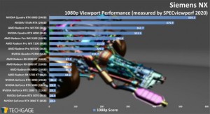

That is not true in all cases. Many high-end CAD platforms perform better on "Pro" cards. Some actually require "Pro" cards as their performance on gaming cards is terrible. Siemens NX is a good example. Others would have some functions disabled when used with a gaming card for stability concerns.
I need the RTX A4000 for my CAD workstation. I was just wondering if LuxCore would benefit from some of the hardware specifics (ECC VRAM for example) and the different drivers?
