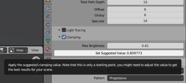

Your problem is just caused by an extremely low clamping value. If you disable variance clamping (or raise the value by a significative amount). The rendering will be fine.
You were "clamping" a tons of light, this is a rendering with your clamping value:
and this without clamping:
You are clearing cutting half of the transported light (and causing artifacts in the process).

Fu*k, this scene was driving me crazy, I was getting out all kind non sense results.
As a reminder this should be put in the tooltips of clamping. ""Too low value can break lighting and create artifacts with GI cache """

Posts: 5672
Re: PhotonGI cash problem
PetrT wrote: Mon Sep 06, 2021 10:08 pm Sorry,It was not the aim of my post.
I guess just another interesting case
I'm not sure to understand the statement but I have the feeling you have to run the rendering without clamping to get a valid suggested value.
