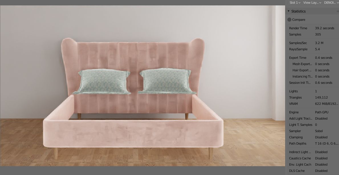

Hi
Have problem with PhotonGI cash
Why shading become broken?
Is it well known fact
with cash
without cash
win 10
last build luxcore
Blender 2.93
Lightning
Env (Flat color)
Photon Cash params
PhotonGI cash problem
Re: PhotonGI cash problem
After unchecking Enviroment Cashe shading become normal
and when i try collect small of scene in new project
problem has gone even if Enviroment Cashe is on

Use of PhotonGI Cache makes results a bit darker.
Not sure, but I think it was already mentioned...
0 - no caches (reference)
1 - PGI (darker) 2 - PGI + ENV (darker) 3 - PGI+ENV+DLS (darker) 4 - ENV (bright as reference w/o caches)

Have you tried to just disable PGI for the material of the bed ?
There's no Disney material used.
Bed & Pillows use Velvet, Walls - Matte, Floor & Structural framing - Glossy+Matte
Disabling PGI on a bed (Velvet) material helps a bit but not fully. And disabling it on Floor, slightly darkens a bit...
I'm thinking it might be Blender's "fix" for color values causing this by influencing Glossines Threshold... or it's just how this scene is set (I haven't gone through all details, since it's a bit of disorganized mess

Just try what he is saying. It should work fine without speed penalty. Just disable Cache on the darkening material.Have you tried to just disable PGI for the material of the bed ?
