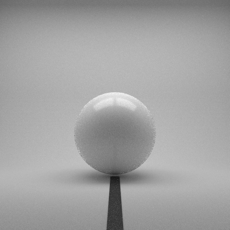

Uh... regarding the disney material... the white halo at the tangent on bright materials is my luxcore problem number 3

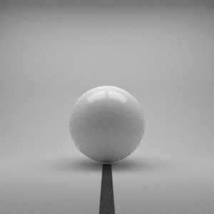

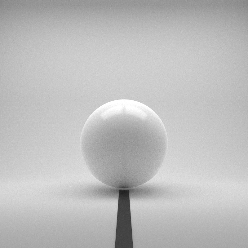

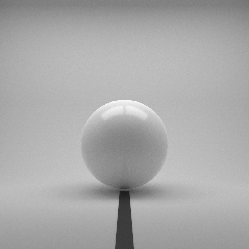

The material here as well as the Luxcore disney doesn't have SSS of any sort.
This bright rim is appearing at grazing angle in certain lighting condition.
Re: Two well known luxcore problems.
Sharlybg wrote: Fri Aug 27, 2021 2:29 pm The material here as well as the Luxcore disney doesn't have SSS of any sort.
Try to wonder what I'm asking ... right, a test scene.
Have you tried to use the Disney parameters with Cycles ?

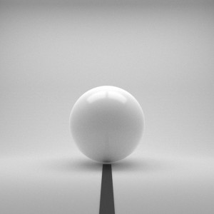

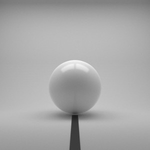

Is it a BiDir only problem ?
Path:
BiDir:

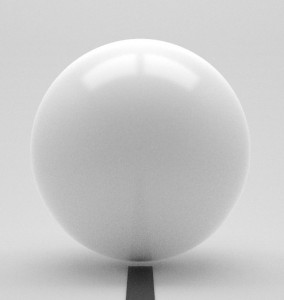

Yes, it is easy to spot the problem using light tracing only rendering:
(the fireflies on the edges)
