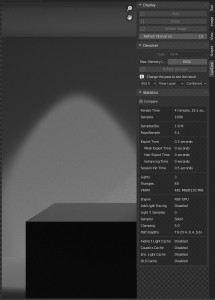

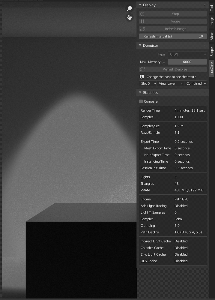

PGI on - Clamp on

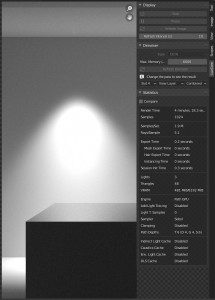

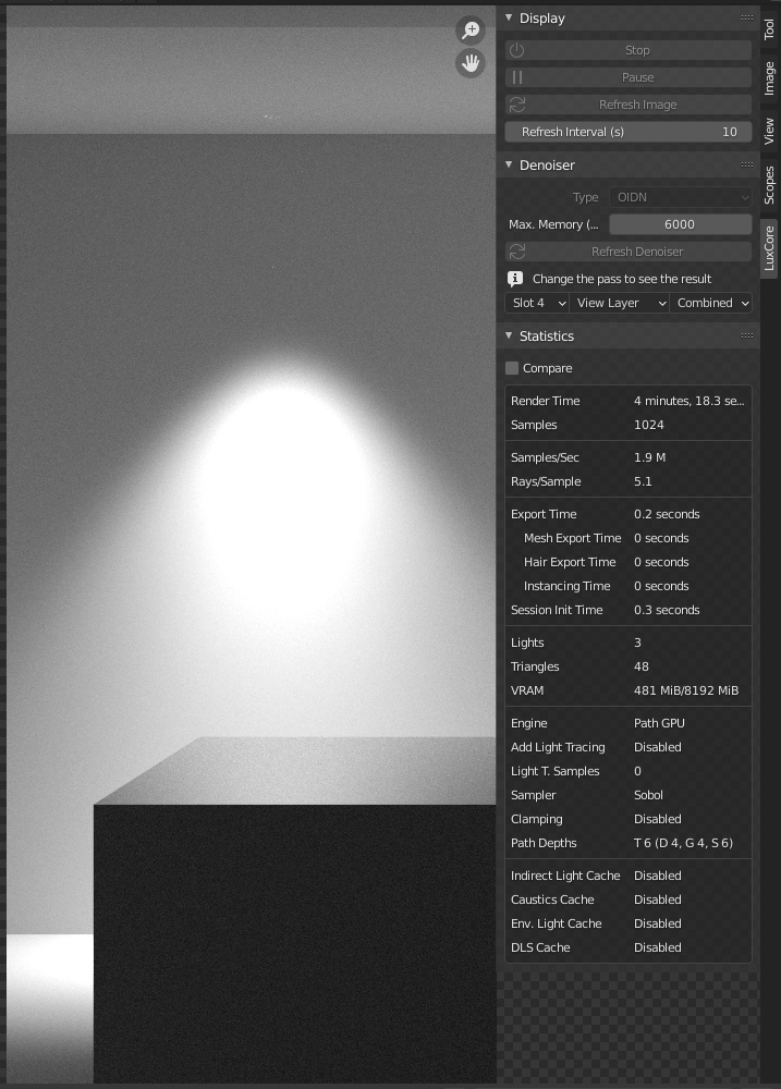

PGI on - Clamp off

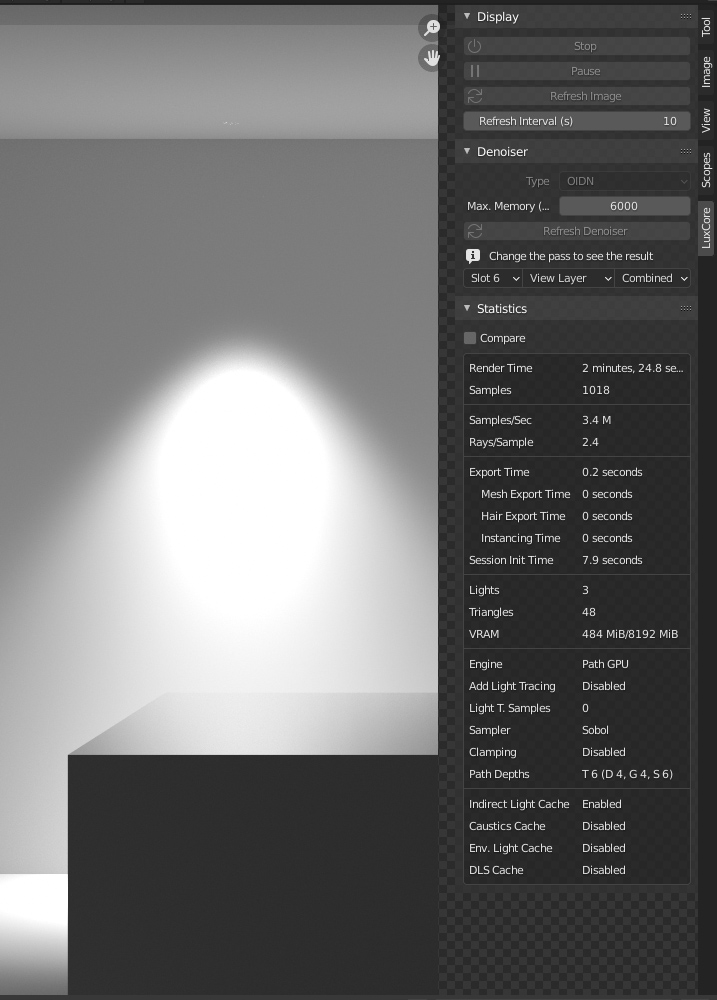

PGI off - Clamp on

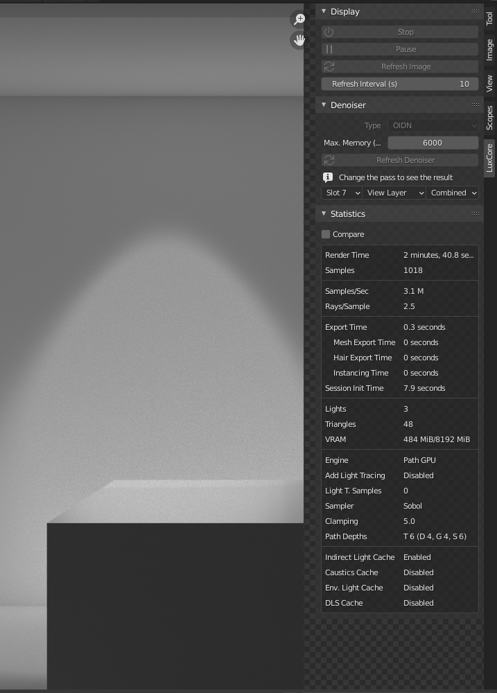

PGI off - Clamp off
In my opinion, the clamped images seem more noisy than the unclamped.
Do you agree?
If yes, is it correct?
I've created a simple scene you can find as attached.
testing_clamp.zip
(124.92 KiB) Downloaded 1187 times
