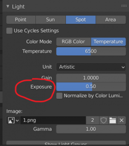

I'm trying to simulating a projector (using spotlight with images), and it only illuminates a simple flat plane with diffused surface. Also, the images are simply 8-bit grayscale images.
I wonder if it is possible to predict the camera image, given the diffuse color of the surface, distance between the surface and projector, projected image, and spotlight exposure? Is there a function governing that?
I notice that I can change the exposure of the spotlight, but I'm not sure how specifically it affects the intensities of the projected image (e.g., after increasing the exposure by 0.1, how will it change the intensities of the projected image?).

Dade wrote: Fri Jul 30, 2021 11:42 am Are you sure to not talk about camera exposure instead of light ?
I guess this is how to control the spotlight intensity, right?

naruto123sdo wrote: Fri Jul 30, 2021 3:03 pm I guess this is how to control the spotlight intensity, right?
I assume yes but it is a BlendLuxCore front-end pre-processing thing: LuxCore doesn't have such parameter, I assume it multiplies the gain by the exposure or something like that.
