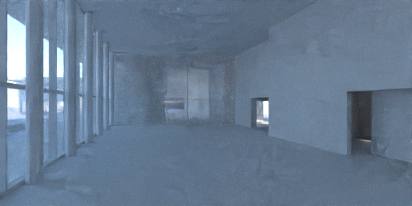

This one is with prefiltering off...
no big difference regarding the transparencies

daros wrote: Thu Jul 08, 2021 7:10 am This one is with prefiltering off...
I think I can fix this problem:
See the normal AOV ? It uses the normal of the glass instead of the normal of the surfaces seen trough the glass (so it is not aligned with the Albedo AOV).
I need to have for normal AOV the same setting I have for Albedo AOV.

Re: New Albedo settings and more Denoiser related changes
Now the Normal AOV is consistent with Albedo AOV settings (compare with my previous post):
I have also added the pre-filtering of normal pass because it can now noise as albedo.
I will now check if I can get something out of the idea of a pre-rendering of Albedo and Normal AOVs.

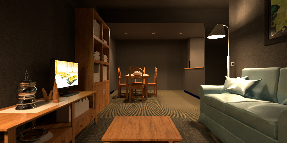

bartek_zgo
Posts: 125
Post by bartek_zgo »
Today I have updated our luxcore to latest commit. Unfortunately I do not see any improvement with denoiser.
With high quality it looks the same. The same problems with carpet.
Old (updated on 7'th Jully):
New (updated today):
With low quality glass looks even worse.
Old
New
