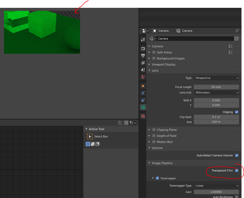

I want to use transparent film with LuxCore standalone. I have setup a simple scene in Blender and it is working:
Than I use "LuxCore Filesaver" to export scene from blender and open it with LuxCore Standalone. The render does not have transparent film.
What is more strange, I have disabled "Transparent film" and reexport the scene and both render.cfg and scene.scn are absolutely identical. So it looks that option "Transparent film" does not have any impact on the scene. Is this option implemented in blender? Should I set another film.output with Alpha channel and than add it to there render manually?

The transparent film option is ignored when exporting with filesaver:
https://github.com/LuxCoreRender/BlendL ... ovs.py#L68
To enable it, open this file and remove the part "and not utils.using_filesaver(context, scene)".
I don't remember why it was implemented like this (should have written a comment), I think it was something with luxcoreui not handling transparent film in a good way.
