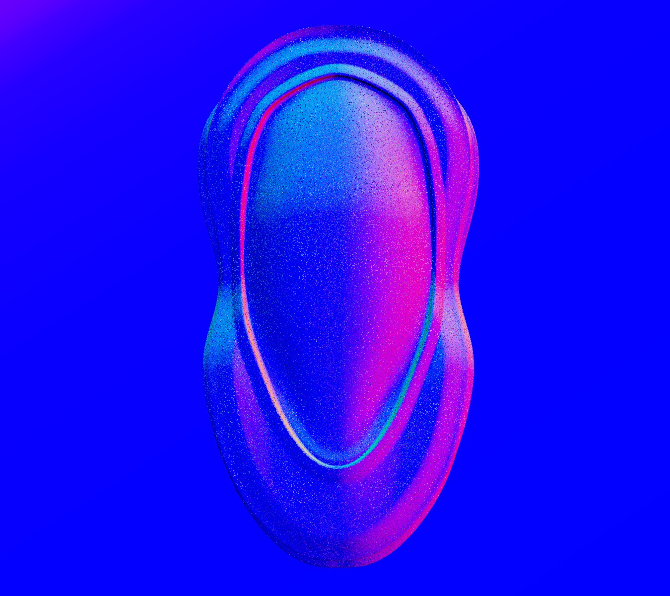

Is it correct to totally disregard SHADING NORMAL pass & denoises anyway?
Eg.
Gold w Bump (Normal map), rendered to 5k samples (Halt Noise Treshold @ 6).
Eg.
Re: New OIDN 1.4 with new features and better detail preservation
In latest sources and with OIDN v1.4, I'm pre-filtering only the Albedo pass but looking at the images I'm starting to think that it may be worth pre-filtering the normal pass too. I will do some test.
I think that looking at the results, the best course of action would be to give the user all the options, so there is a default behavior, but the user can go and decide what happens with each pass and how OIDN should treat them.
OIDN uses the Avg. Shading Normal pass (Avg. = Average).kintuX wrote: Wed Jun 23, 2021 10:50 am Is it correct to totally disregard SHADING NORMAL pass & denoises anyway?
In the Blender addon, it is enabled automatically behind the scenes when the denoiser is used.
Oh, so that's why details are gone. (Yes, avg. nrml pass was smooth)B.Y.O.B. wrote: Wed Jun 23, 2021 11:32 amOIDN uses the Avg. Shading Normal pass (Avg. = Average).kintuX wrote: Wed Jun 23, 2021 10:50 am Is it correct to totally disregard SHADING NORMAL pass & denoises anyway?
Is there a simple way to switch it?
For OIDN to use "Shading normal" instead of "Avg." pass.
