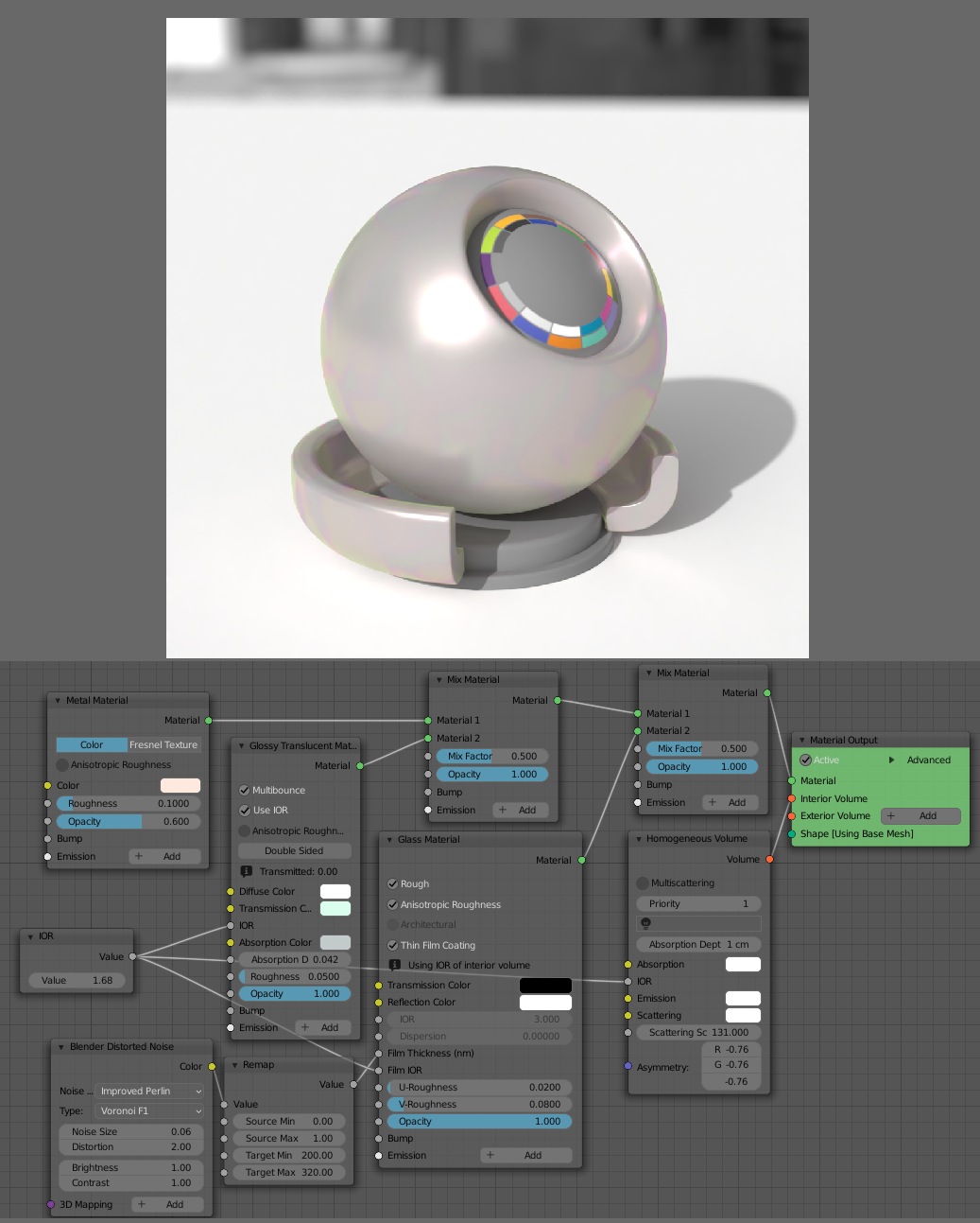

For anybody interested, I converted the old values into a node tree setup. See attached w/ a sample render, too.
Any input is very welcome of course.

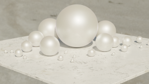

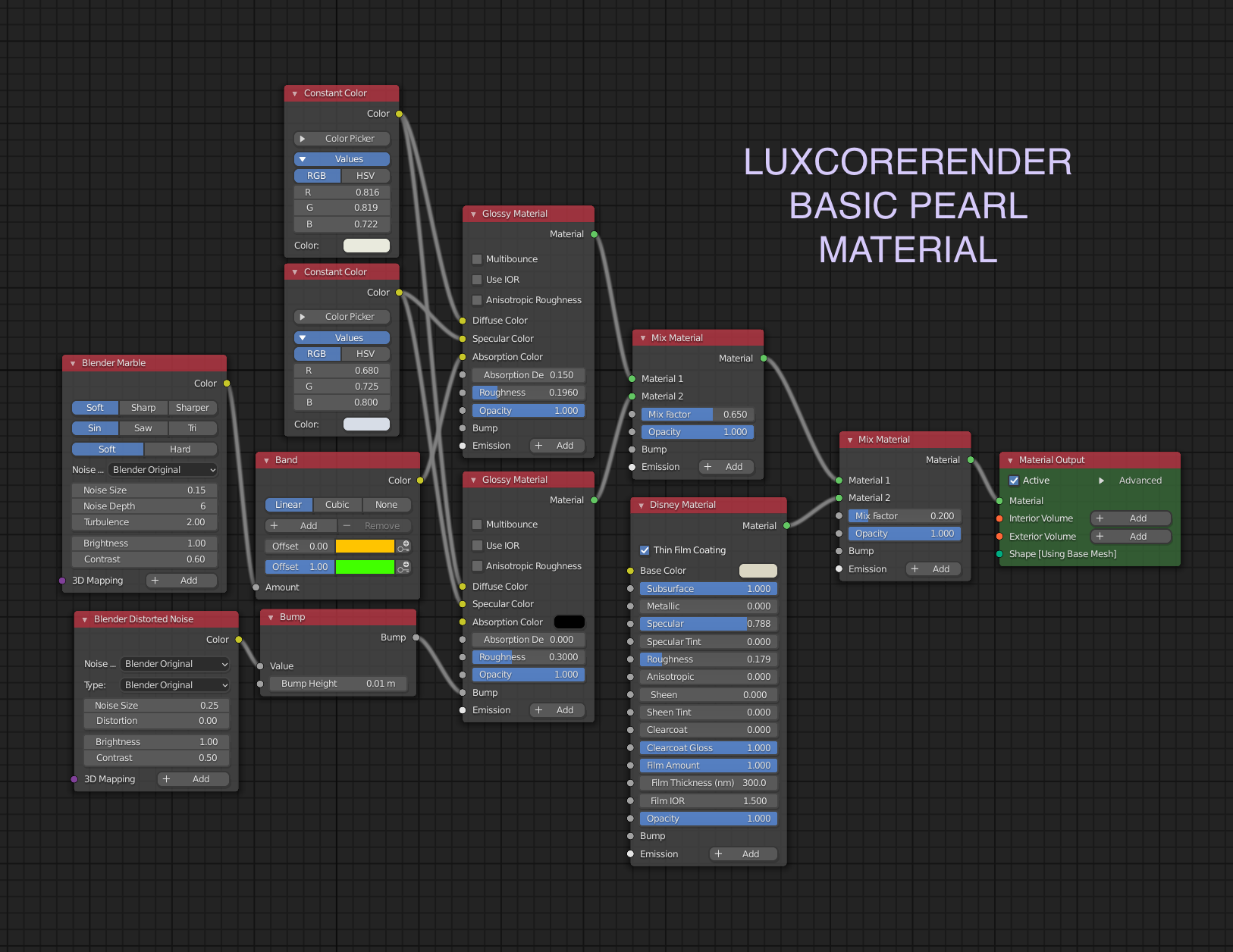

And a different go for pearlescent material.

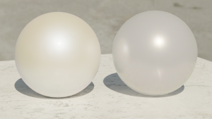

I put the two of them side by side for a little test if anybody is curious. Mine is on left, yours on right. Nice to see the different approaches together. I think my version of yours could use some tweaking on the noise size, but I like it.
Posts: 821
Re: Pearl material
True, depending on the size of geo, noise and volume must be tweaked.
