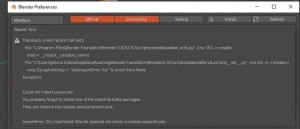

The new build of Blendluxcore on windows is giving this error.

Do you try to use Luxcore addon in Blender 2.93?JulianoLisboa wrote: Mon May 31, 2021 12:42 pm The new build of Blendluxcore on windows is giving this error.
It does not work at moment.
Cheers, mib

It doesn't work in blender 2.92, something is wrong.

I use 2.92 and last week's build was working fine.mib2berlin wrote: Mon May 31, 2021 2:59 pmDo you try to use Luxcore addon in Blender 2.93?JulianoLisboa wrote: Mon May 31, 2021 12:42 pm The new build of Blendluxcore on windows is giving this error.
Cheers, mib

I am sorry, testing 2.92 again and you are right.JulianoLisboa wrote: Mon May 31, 2021 3:22 pmI use 2.92 and last week's build was working fine.mib2berlin wrote: Mon May 31, 2021 2:59 pmDo you try to use Luxcore addon in Blender 2.93?JulianoLisboa wrote: Mon May 31, 2021 12:42 pm The new build of Blendluxcore on windows is giving this error.
Cheers, mib
Cheers, mib

It is compiled with Python v3.9 so it can not work with Blender v2.92. It requires v2.93 however BlendLuxCore hasn't been yet updated for v2.93 so you can't really use daily builds at the moment. We are in the middle of the transition.

How can I download a version of 2.6 that still works at 2.92?Dade wrote: Mon May 31, 2021 4:33 pm It is compiled with Python v3.9 so it can not work with Blender v2.92. It requires v2.93 however BlendLuxCore hasn't been yet updated for v2.93 so you can't really use daily builds at the moment. We are in the middle of the transition.

If you replace the pyluxcore.pyd and all .dll files with the one included in this .zip, it should work with v2.92: https://drive.google.com/file/d/19lAqUm ... sp=sharingJulianoLisboa wrote: Mon May 31, 2021 5:37 pmHow can I download a version of 2.6 that still works at 2.92?Dade wrote: Mon May 31, 2021 4:33 pm It is compiled with Python v3.9 so it can not work with Blender v2.92. It requires v2.93 however BlendLuxCore hasn't been yet updated for v2.93 so you can't really use daily builds at the moment. We are in the middle of the transition.

You'll have to be patient, currently the daily builds work neither in 2.92 (because of the newer Python version) nor in 2.93 (because of some changes in the Blender Python API). We'll fix this soon.
