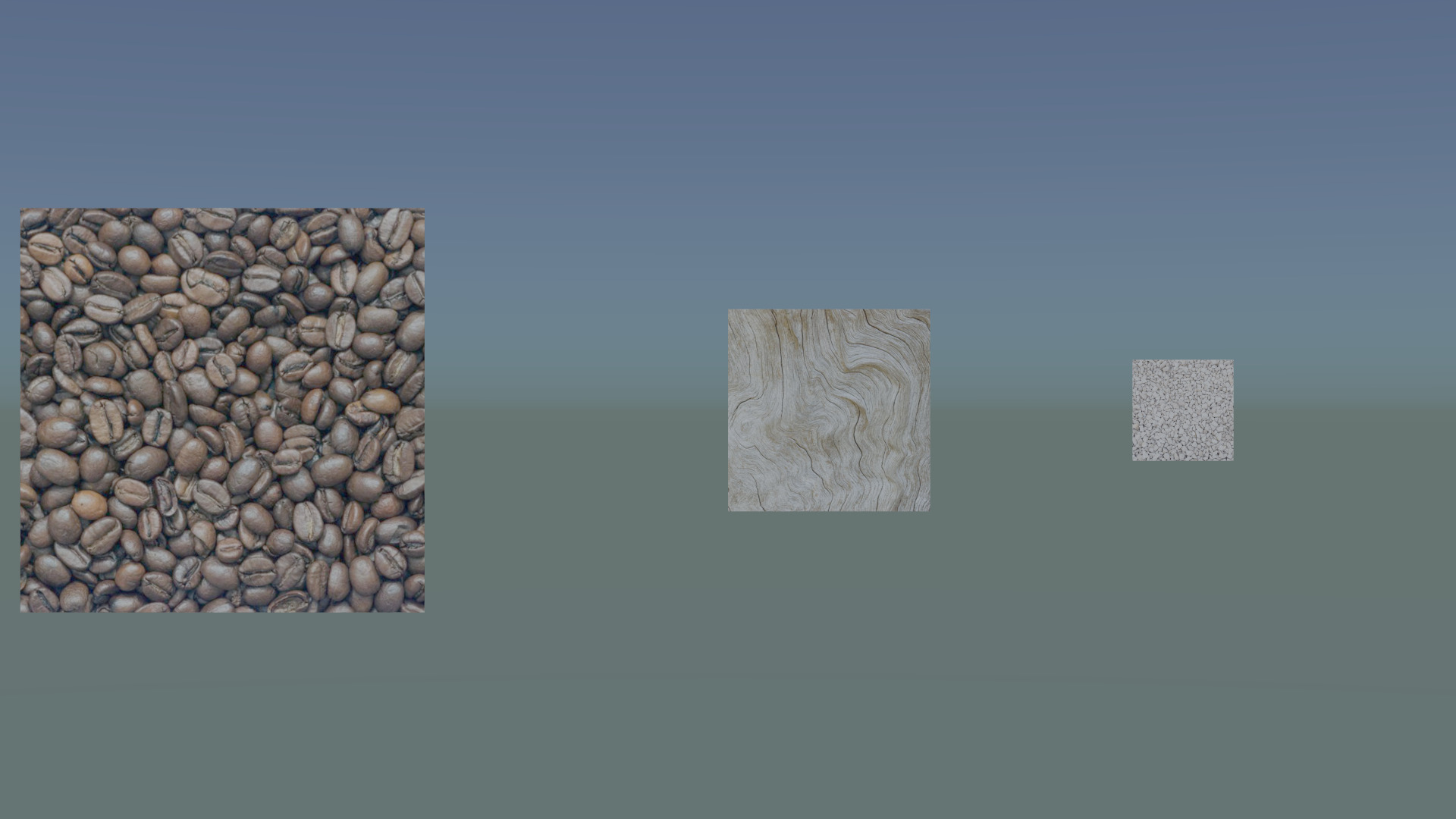

This is reference rendering (all the image maps are 512x512):
Using:
[LuxRays][0.524] [Device GeForce RTX 2070 SUPER CUDAIntersect] ImageMaps buffer size: 5376Kbytes
And this is the MINMEM rendering:
Using:
[LuxRays][1.160] [Device GeForce RTX 2070 SUPER CUDAIntersect] ImageMaps buffer size: 4099Kbytes
The quality is the same but I have saved ~25% of the GPU ram.
The log show what MINMEM does:
[LuxCore][0.593] Resize policy preprocess thread count: 24
[SDL][0.855] Image maps "scenes/randomizedtiling/pattern-3.jpg" optimal resize: 512x512 => 533x533
[SDL][0.855] Image maps "scenes/randomizedtiling/pattern-7.jpg" optimal resize: 512x512 => 266x266
[SDL][0.855] Image maps "scenes/randomizedtiling/pattern-9.jpg" optimal resize: 512x512 => 133x133
[SDL][0.855] WARNING: image maps "scenes/randomizedtiling/pattern-3.jpg" too small !
[SDL][0.855] Reading texture map: scenes/randomizedtiling/pattern-3.jpg
[SDL][0.880] Image maps "scenes/randomizedtiling/pattern-3.jpg" scaled: 512x512 => 512x512
[SDL][0.880] Reading texture map: scenes/randomizedtiling/pattern-7.jpg
[SDL][0.942] Image maps "scenes/randomizedtiling/pattern-7.jpg" scaled: 512x512 => 266x266
[SDL][0.942] Reading texture map: scenes/randomizedtiling/pattern-9.jpg
[SDL][0.998] Image maps "scenes/randomizedtiling/pattern-9.jpg" scaled: 512x512 => 133x133
[SDL][0.998] Applying resize policy MINMEM time: 0.4secs
It shows the optimal resolution for each image maps. It even tells me that 512x512 is not enough for the larger quad (533x533 is the optimal resolution).

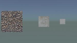

Now let's render with the same scene at a lower resolution (960x540 instead of 1920x1080):
MINMEM uses even less ram thanks to the lower rendering resolution:
[LuxRays][0.923] [Device GeForce RTX 2070 SUPER CUDAIntersect] ImageMaps buffer size: 3343Kbytes
Because the optimal resolutions are even smaller:
[LuxCore][0.652] Resize policy preprocess thread count: 24
[SDL][0.726] Image maps "scenes/randomizedtiling/pattern-3.jpg" optimal resize: 512x512 => 266x266
[SDL][0.726] Image maps "scenes/randomizedtiling/pattern-7.jpg" optimal resize: 512x512 => 133x133
[SDL][0.726] Image maps "scenes/randomizedtiling/pattern-9.jpg" optimal resize: 512x512 => 66x66
[SDL][0.726] Reading texture map: scenes/randomizedtiling/pattern-3.jpg
[SDL][0.793] Image maps "scenes/randomizedtiling/pattern-3.jpg" scaled: 512x512 => 266x266
[SDL][0.793] Reading texture map: scenes/randomizedtiling/pattern-7.jpg
[SDL][0.852] Image maps "scenes/randomizedtiling/pattern-7.jpg" scaled: 512x512 => 133x133
[SDL][0.852] Reading texture map: scenes/randomizedtiling/pattern-9.jpg
[SDL][0.907] Image maps "scenes/randomizedtiling/pattern-9.jpg" scaled: 512x512 => 66x66
[SDL][0.907] Applying resize policy MINMEM time: 0.3secs

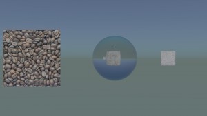

Let's make the scene more complex with a glass sphere:
It uses even less ram because the optimal size of the middle quad is even smaller:
[LuxCore][0.625] Resize policy preprocess thread count: 24
[SDL][0.702] Image maps "scenes/randomizedtiling/pattern-3.jpg" optimal resize: 512x512 => 266x266
[SDL][0.702] Image maps "scenes/randomizedtiling/pattern-7.jpg" optimal resize: 512x512 => 71x71
[SDL][0.702] Image maps "scenes/randomizedtiling/pattern-9.jpg" optimal resize: 512x512 => 66x66
[SDL][0.702] Reading texture map: scenes/randomizedtiling/pattern-3.jpg
[SDL][0.776] Image maps "scenes/randomizedtiling/pattern-3.jpg" scaled: 512x512 => 266x266
[SDL][0.776] Reading texture map: scenes/randomizedtiling/pattern-7.jpg
[SDL][0.843] Image maps "scenes/randomizedtiling/pattern-7.jpg" scaled: 512x512 => 71x71
[SDL][0.843] Reading texture map: scenes/randomizedtiling/pattern-9.jpg
[SDL][0.901] Image maps "scenes/randomizedtiling/pattern-9.jpg" scaled: 512x512 => 66x66
[SDL][0.901] Applying resize policy MINMEM time: 0.3secs
From original 512x512 (and 133x133 optimal without glass lens) to 71x71.

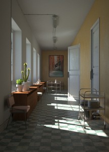

This is a rendering of HallBench scene:
And this is the same rendering with MINMEM:
The saved memory is:
[SDL][34.015] Memory required for original Image maps: 272710Kbytes
[SDL][34.015] Memory required for MINMEM Image maps: 46985Kbytes
It requires 5.8 times less memory ! 46MB Vs 272MB.
