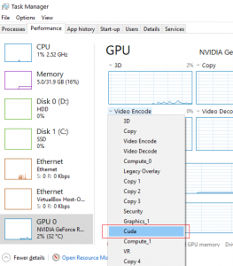

Re: Does not seem to use my GPU
What are you using to check the GPU workload ? On Windows, you have to select GPU computing workload, not normal gfx related one.

I am just using task manager to see if the GPU is being used as it was taking longer then before to render things. I have selected all the GPU option in blender as I used to do.

mardymarvin wrote: Mon May 10, 2021 6:35 pm I am just using task manager to see if the GPU is being used as it was taking longer then before to render things. I have selected all the GPU option in blender as I used to do.
What about GPUz

Well that will teach me for relying on a microsoft product I guess I just thought that it would show if the GPU is being used like when watching videos or like the radeon pro render it goes upto 100%. I have used GPUz thanks sharlybg and that does in deed show that the GPU is being 100% utilised when only the standard task manager show 10%. So I guess microsoft and radeon pro render must report usage differently to CPUz and how luxcore is using the card.
Thanks to all for help and advice
You need to switch one of the GPU diagrams to Cuda:
