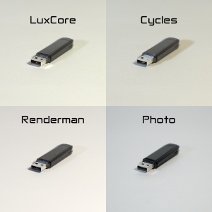

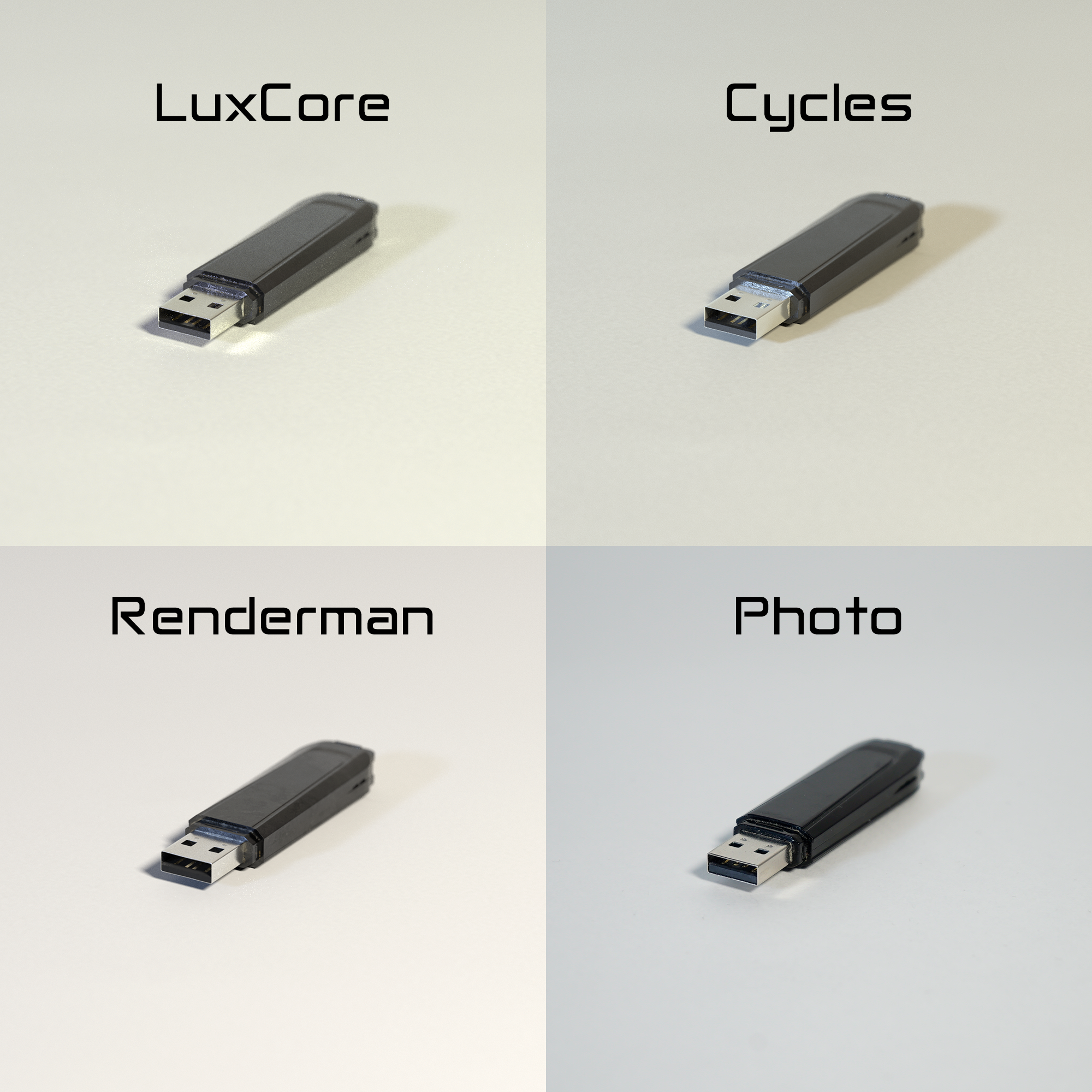

Scene scale is the same in all scenes. The settings for the camera (and lens) are all set to the same as the camera we used to take the real photo. LuxCore does indeed originate the rays from a perfect circle as opposed to renderman, Arnold and cycles that use the shape of an aperture with a certain amount of aperture blades (in our case 7). But I assume this is not the only difference between the renderers when it comes to depth of field since none of them have the same look, even the ones that have the same amount of aperture blades.

Yes, this is exactly what we did, and the results show that there is a clear difference between the images when it comes to depth of field depending on what renderer was used :) Believe it or not but one of the guys at Arnold was actually the first to respond! Now we just need to figure out how the other renderers do it.

No circular shape is named bokeh distribution in LuxCore and it is supported in v2.5: https://luxcorerender.org/new-features-in-v2-5/
The distribution inside the bokeh shape has a huge impact on how DoF looks and it may explain the differences you are observing (this kind of parameters are fully configurable in LuxCore but you have to look in bokeh configuration).

Thank you kindly for your response! :) It definitely clears things up a bit more!
My bad, I should have clarified, the image vas rendered using LuxCore 2.4
