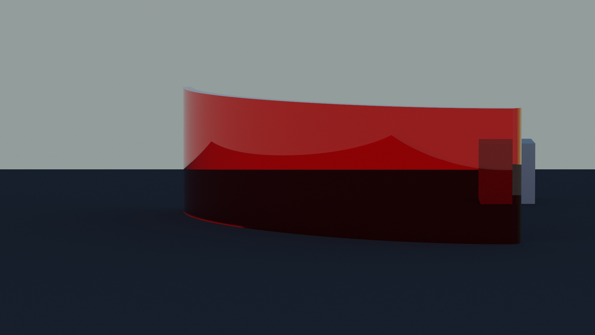

Is this better now?
I just followed Dade advice and appropriated all the interior/exterior volumes
I guess you are right however that refraction and reflection were computed according to the ratio of the IORs of internal and external volume of the Object and independent of the IORs of other Objects. :geek:
BR
Test_Scene_c.zip
(1.84 MiB) Downloaded 1254 times

Hello,
the appearance looks better, but still not right.
The material edges look strange to me.
Also strange is that that the exterior needs to be defined even if it's idential with world volume (that should be air by default with IOR 1).

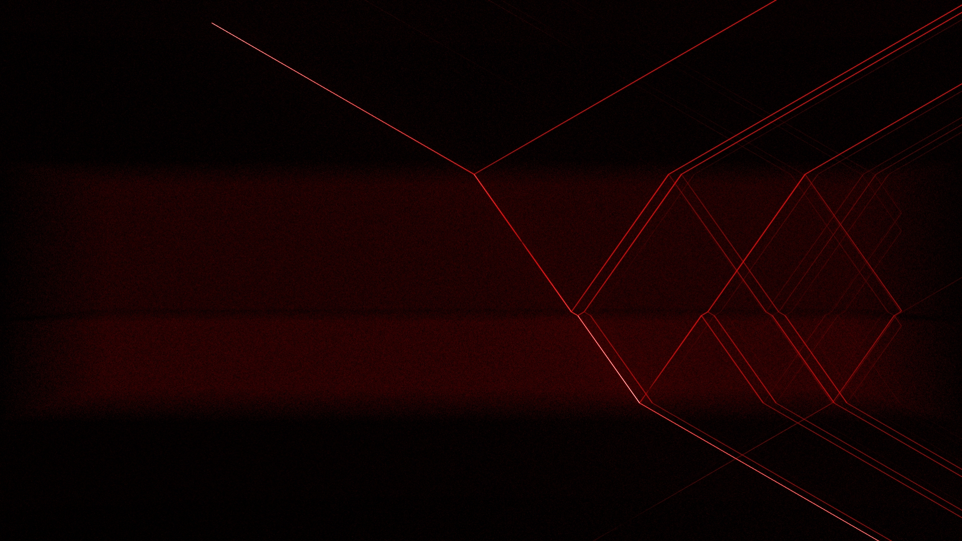

Do we agree that the light path through the test system should look like this?
I mean the direction of the transmitted ray (not the green color).
The system seems to be defined correctly, is that right?
t2_mod.blend
(994.5 KiB) Downloaded 1206 times

lighting_freak wrote: Wed Apr 21, 2021 9:43 am Do we agree that the light path through the test system should look like this?
I agree if both the above rules are followed. No 0 gap and both exterior and interior volumes of the Object are defined and equal.

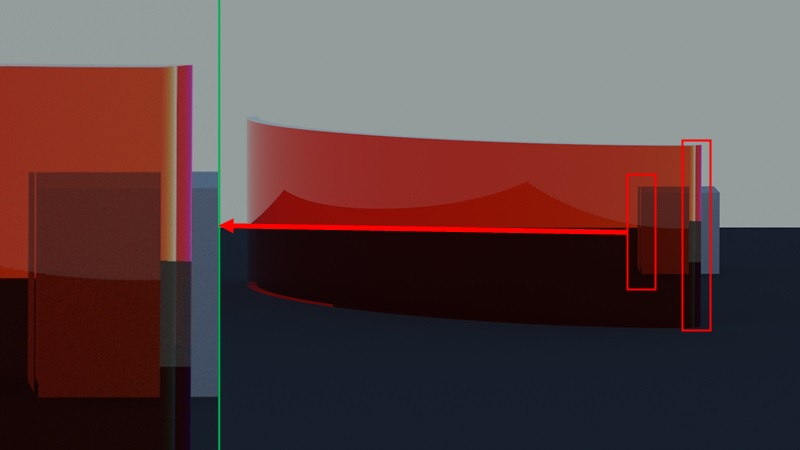

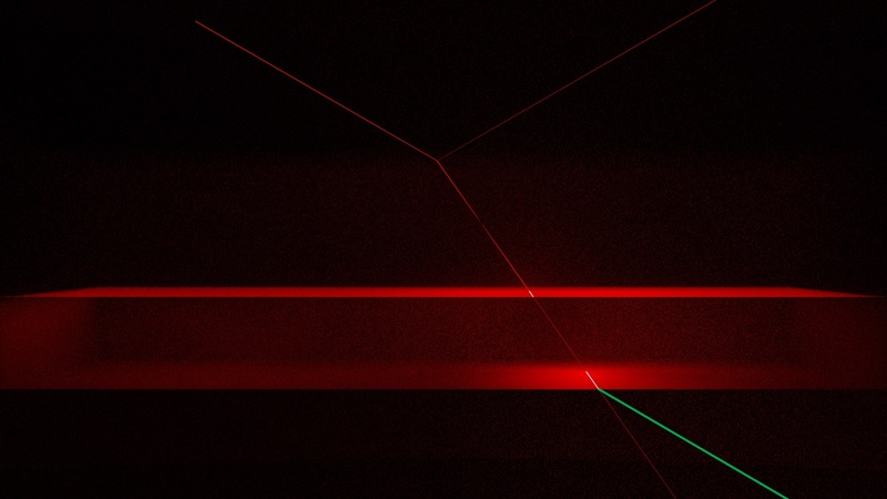

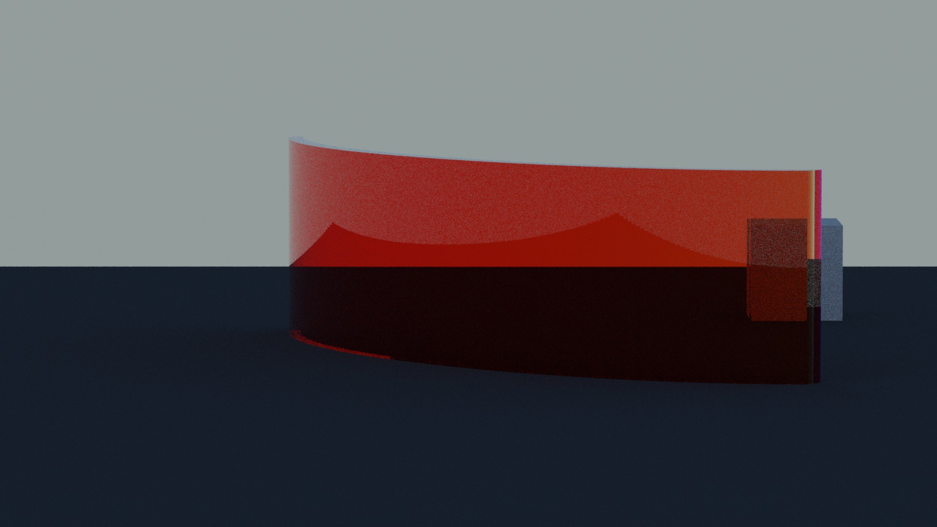

I've updated the scenes with a slit (air gap).
Both deliver the result that I would expect while having this air gap.
This is the result of the light path scene (hope this one works out of the box):
t2_mod_slit.blend
(1000.47 KiB) Downloaded 1219 times
This is the result of the two plastic parts:
Test_Scene_slit.blend
(1.22 MiB) Downloaded 1236 times
However, I'm still looking for right setup, leading to right results, without such an air gap.
I read the posts about the world and the camera space.
Maybe I'm to stupid to get the point of it, but the geometry is not far away from the origin and the parts are not that small that this effects should appear, also the camera is only few meters away.

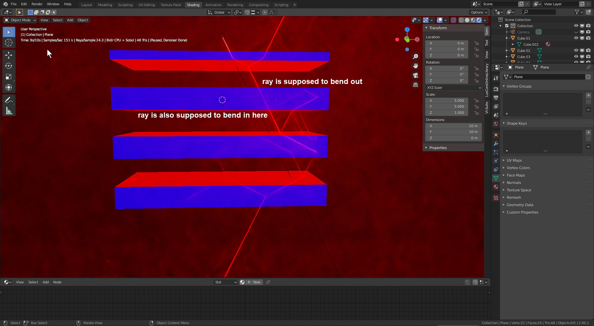

Maybe for the sake of performance and also Dade has said floating point numbers are like lego so IMO that means if you set distances to zero overlapping surfaces will have both negative and positive distances and also light rays from a surface do not travel backward and therefore the strange artifacts of light and dark.

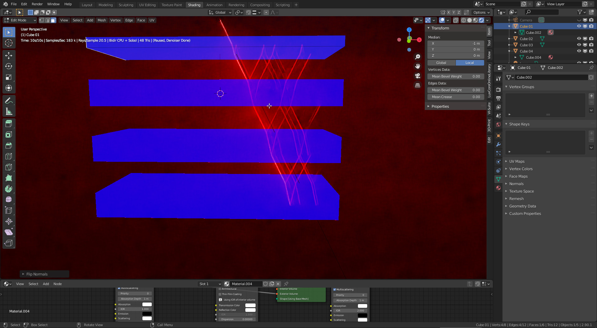

Glad some progress have been made here! :) However I also got confuse when trying to figure out your original testscene.blend. I tried to replicate by flipping some Faces inside out and trace it with Laser but only to find out Refraction and Reflection stops working on some interfaces. :? Please kindly check.
Refraction and Reflection on the 2nd Glass Object below the First Glass Object no longer works if Faces are flipped. If Disable the 2nd Glass Object the issue will pass to the Third Glass Object below and so on.... If disable the 1st Glass Object 2nd, 3rd, 4th all will work normally.
Work as expected when Faces are not flipped.
Can anyone explain? :mrgreen:
strange.blend
(935.49 KiB) Downloaded 1168 times
normal.blend
(935.52 KiB) Downloaded 1182 times

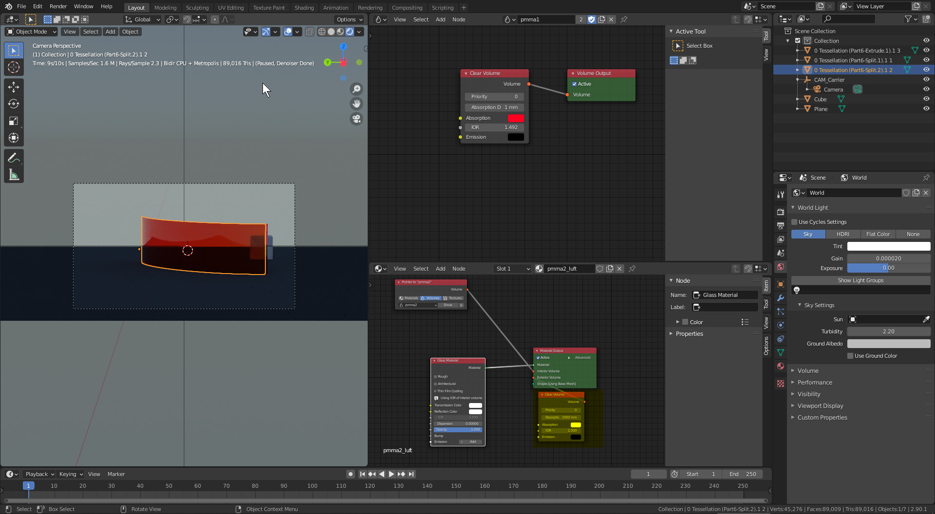

Jan wrote: Sat Apr 24, 2021 2:06 pm if you set distances to zero overlapping surfaces
There are no overlapping surfaces in that model.
One of the two faces that are shared by both volumes is deleted (or better said: has never been imported).
The remaining surface (marked in red) carries an interior and exterior volume as mentioned in this image:
Jan wrote: Sat Apr 24, 2021 2:06 pm Glad some progress have been made here!
Well now we know that everything works as it should if you don't have any volume contact situation.
My work really needs some solution for that - we're dealing quite often with such geomterical setups.
Is this setup right in general if one wants to handle this volume contact case?
I'll just like to share it again with more precide naming:
Test_Scene.zip
(1.67 MiB) Downloaded 1225 times
Jan wrote: Sat Apr 24, 2021 2:06 pm Refraction and Reflection on the 2nd Glass Object below the First Glass Object no longer works if Faces are flipped
I think if you start flipping the face normals (see the arrows in the image) the algorythm will be confused with what is inside an outside of the volume.
