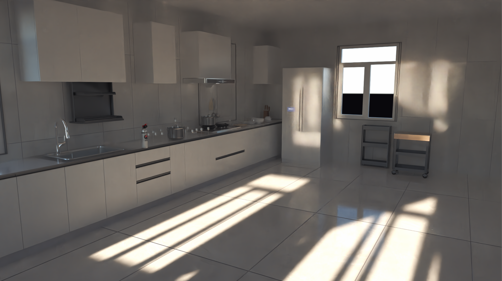

here we have a scene rendered with luxcore, but the results turn outs to be really dull and not looking correct. I was thinking is this something to do with view transform like what blender did? we also use Optix AI denoise that comes with luxcore. here is the rendering result. i know the whole scene texture is grey and white which contribute to the dull render, but I render the same scene in blender and it came out nice and shiney. we have no idea where we messed up. we are using HDRI lighting to light up the scene. any thoughts or direction will be appreciated!
thanks in advance!
here is the rendering config we had in our code(modified a little bit)
CPU: I7-10750
GPU : 2070 8G
ram:16g
mapNameConfig["film.filter.type"] = "NONE";
mapNameConfig["film.width"] = std::to_string(render_width);
mapNameConfig["film.height"] = std::to_string(render_height);
mapNameConfig["path.photongi.indirect.enabled"] = "0";
mapNameConfig["path.photongi.caustic.enabled"] = "0";
mapNameConfig["path.pathdepth.total"] = "5";
mapNameConfig["lightstrategy.type"] = "LOG_POWER";
mapNameConfig["scene.epsilon.min"] = "9.9999997473787516e-06";
mapNameConfig["scene.epsilon.max"] = "0.10000000149011612";
mapNameConfig["renderengine.type"] = "PATHOCL";
mapNameConfig["sampler.type"] = "SOBOL";// "SOBOL";TILEPATHSAMPLER
mapNameConfig["film.opencl.enable"] = "1";
mapNameConfig["film.opencl.device"] = "2";
mapNameConfig["opencl.cpu.use"] = "0";
mapNameConfig["opencl.gpu.use"] = "1";
mapNameConfig["batch.haltspp"] = "100";
mapNameConfig["batch.halttime"] = "0";
mapNameConfig["native.threads.count"] = "6";
mapNameConfig["path.clamping.variance.maxvalue"] = "0";
mapNameConfig["film.imagepipelines.0.0.type"] = "OPTIX_DENOISER"; //OPTIX_DENOISER \INTEL_OIDN
mapNameConfig["film.imagepipelines.0.0.minspp"] = "0"; //OPTIX_DENOISER \INTEL_OIDN
mapNameConfig["film.imagepipelines.0.0.sharpness"] = "0.3"; //OPTIX_DENOISER \INTEL_OIDN
mapNameConfig["film.imagepipelines.0.1.type"] = "NOP";
mapNameConfig["film.imagepipelines.0.2.type"] = "TONEMAP_AUTOLINEAR";
mapNameConfig["film.imagepipelines.0.2.scale"] = "2";
mapNameConfig["film.imagepipelines.0.3.type"] = "GAMMA_CORRECTION";
mapNameConfig["film.imagepipelines.0.3.value"] = "2.2000000000000002";
mapNameConfig["film.imagepipelines.0.4.type"] = "COLOR_LUT";
mapNameConfig["film.imagepipelines.0.4.file"] = fsGetResourceDirectory(RD_TEXTURES)+std::string("/lut/1.cube");
mapNameConfig["film.imagepipelines.0.4.strength"] = "0.5";
mapNameConfig["film.imagepipelines.0.radiancescales.0.enabled"] = "1";
mapNameConfig["film.imagepipelines.0.radiancescales.0.globalscale"] = "1";
