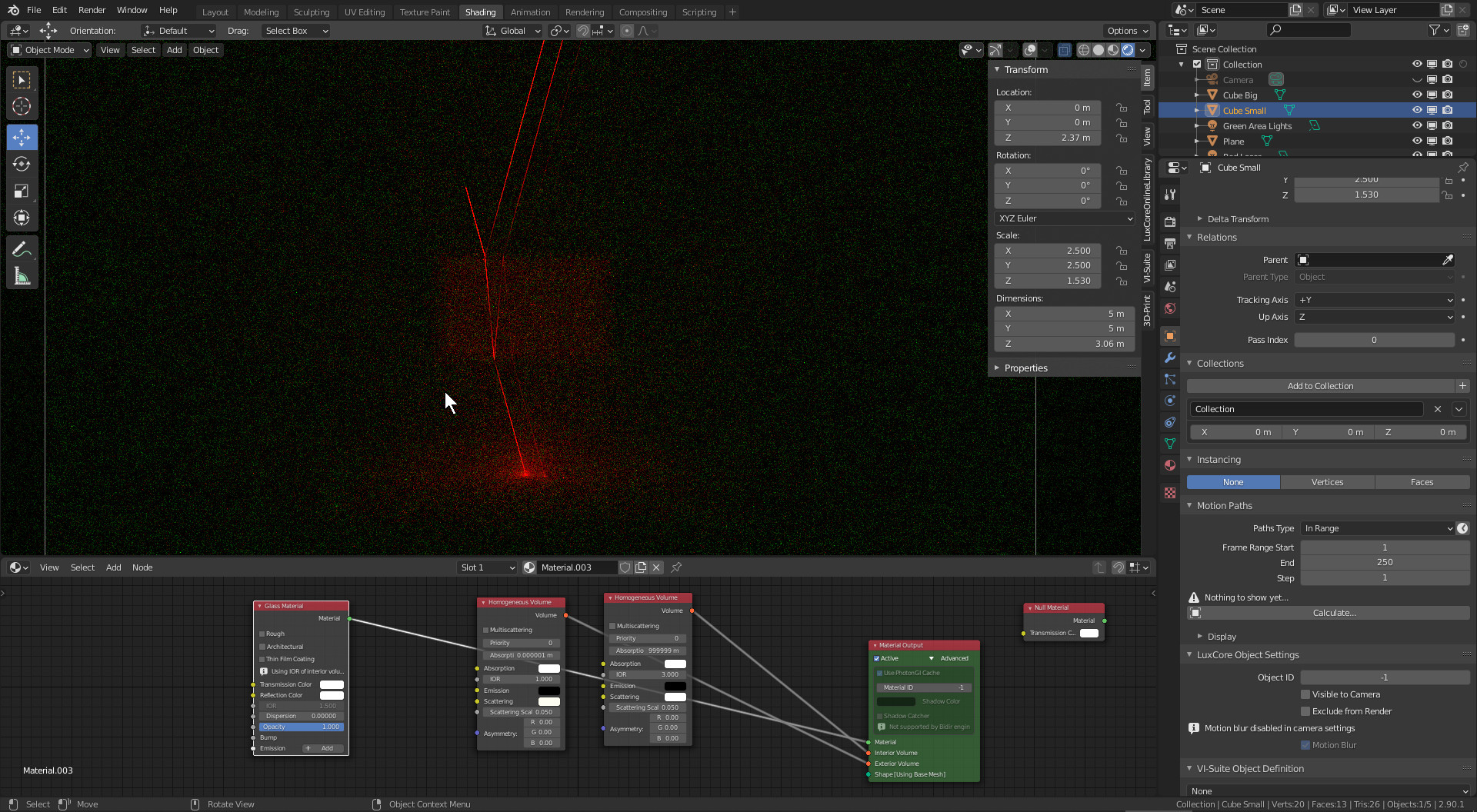

Hi, I am having problems rendering both Transmission and Reflection simultaneously in Glass materials. It is either only one or the other.
Here is the setup:
Green Area Lights pointing perpendicularly to the Glass Object from some distance and so was the viewing direction and expect maximum reflection.
Red Laser Lights above and entering at a angle toward the Glass Object with Homogeneous Volume Inside and expect Transmission to any viewing direction.
However these are what I got:
Only Reflected Green Area Lights from Glass Object is visible while a segment of Red Laser Lights inside the Glass Object cannot be seen when Visible to Camera is enabled.
Only Transmitted Red Laser Lights is visible while reflected Green Area Lights cannot be seen when Visible to Camera is disabled.
Are there other settings or fine tuning to make to allow for both to show up please???

Glass Cube Object - Visible to Camera Unchecked
Glass Cube Object - Visible to Camera Unchecked Volumetric lights are lost and maybe as well Torus Object bounce light reflections from Matte Plane Object underneath.

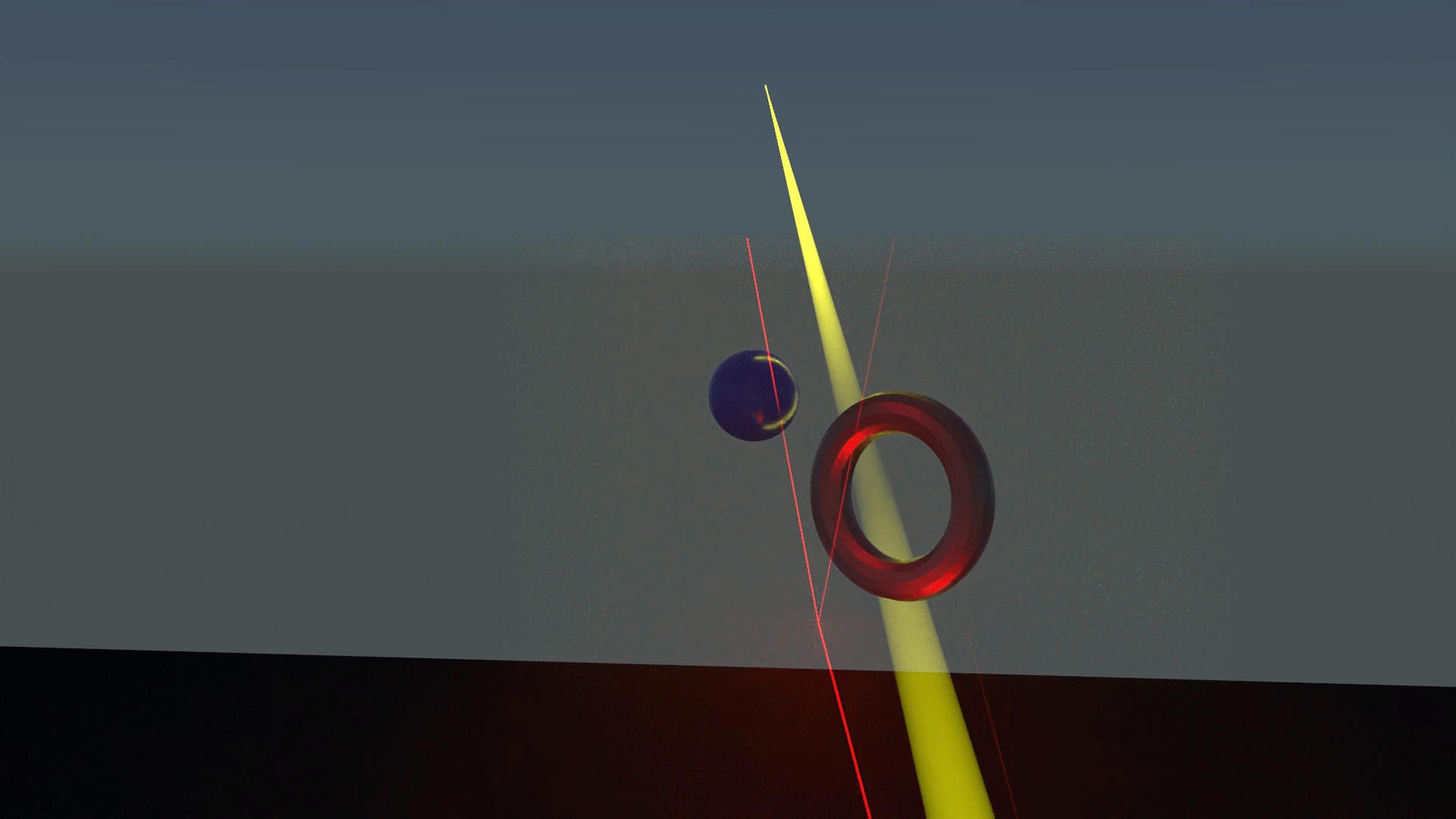

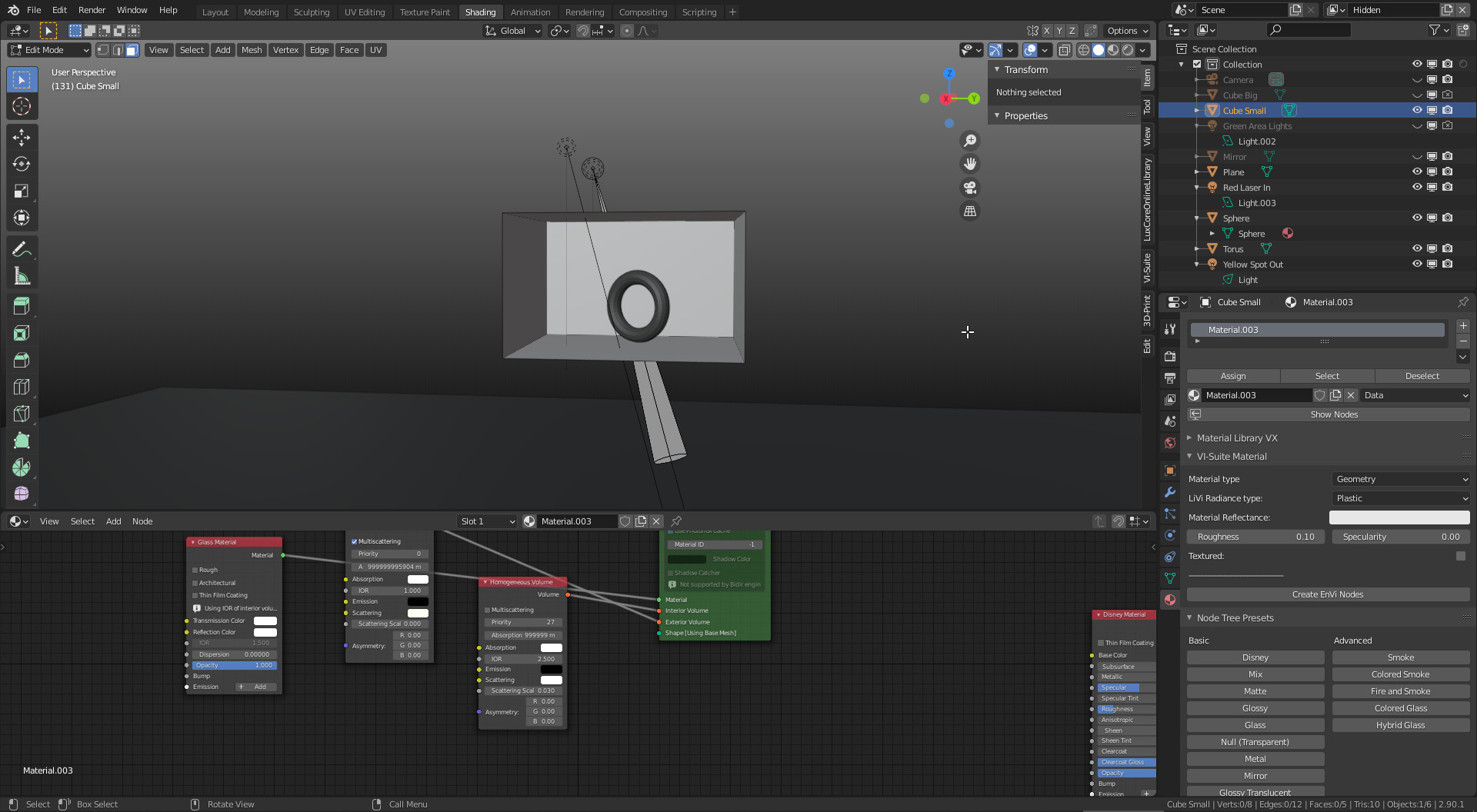

Also removed the Glass Cube Object Front Face so the Laser will be visible now and then try to reflect it from a Mirror Object.
Front View cannot even understand why the volumetric lights suddenly turned so red and overshadowed the blue color of the Sky
Mirrored View mirrored image degraded while Volumetric Lights are still invisible
p.s. they were all rendered using Bidir
