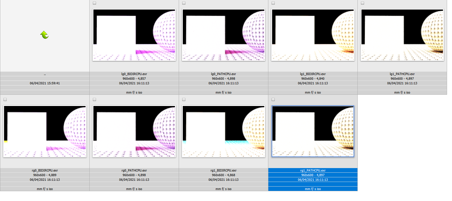

You may think that I'm "stupid or something" but I'm not.
I copy your pipelines and repeat the test. I got the same error. So I started to compare your scene and mine. What I have found:
if I render with BIDIRCPU the radiance group images are broken, when I render with PATHCPU they are OK!
If you render please wait until 20spp. Before the difference is invisible. More the render takes, more the difference is visible. Take a look at: rg1_BIDIRCPU.exr vs rg1_PATHCPU.exr Here you can find complete scene with exr images:
https://files.fm/u/a69zxnrh8
