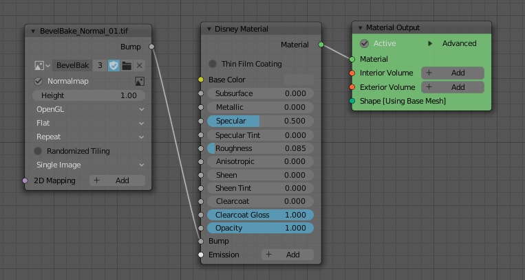

And here is the node setup that I used in Luxcore.

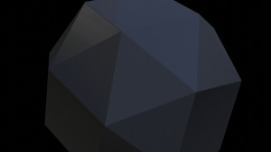

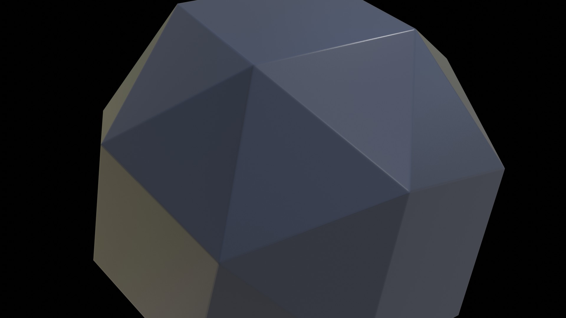

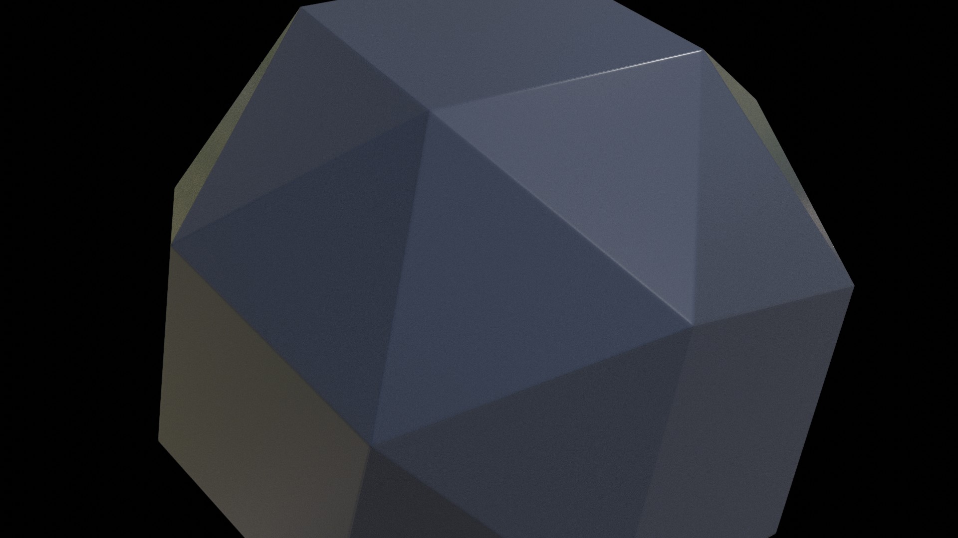

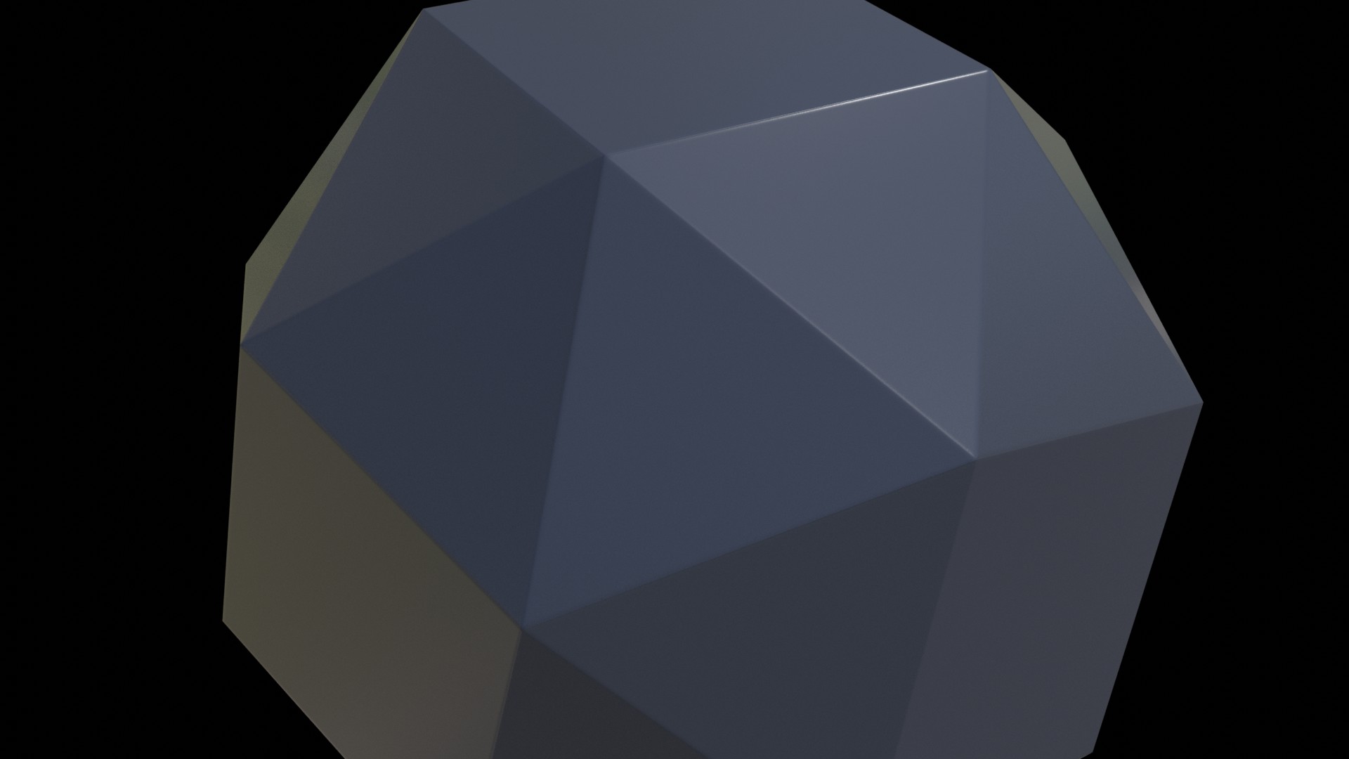

imported fbx, set scene for cycles, rendered with eevee & cycles for reference,
switch to LuxCore, "use cycles settings", set ibl/hdr, render looks fine...
Cycles
Eevee
LuxCore
LuxCore Node Tree
1. edit: updated with LuxCore Material Node Tree
2. edit: indeed, after further testing it looks like there's discrepancy in one of the axes(?)

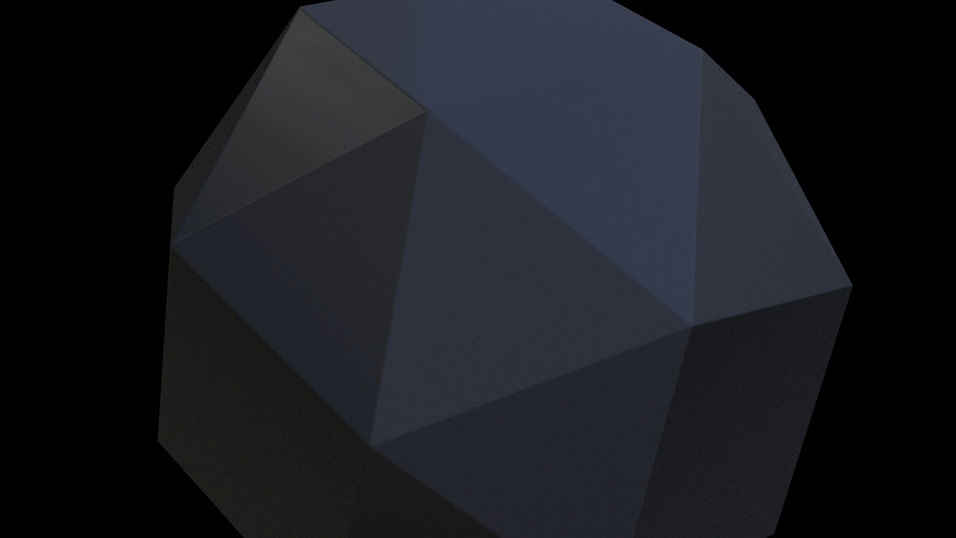

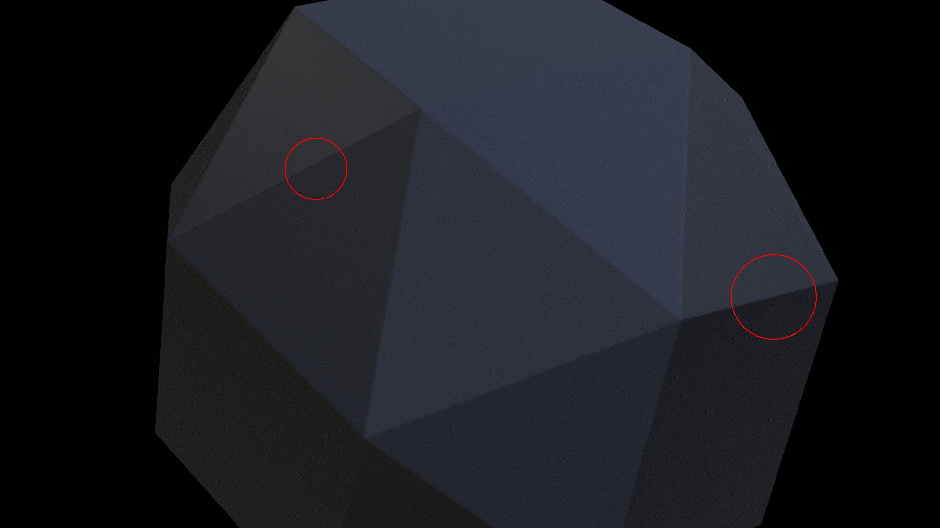

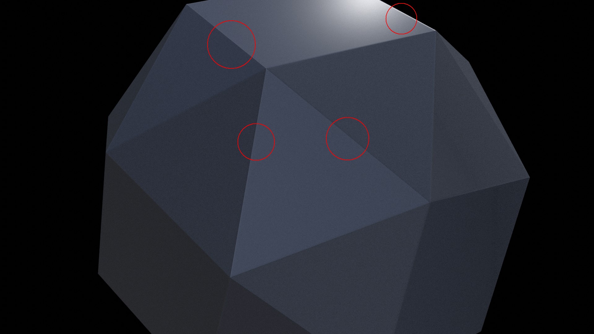

Thanks for giving it a try and the elaborate reply. But somehow I can't get it to work properly - even with your scene.
Here are the 4 version that I compared. As you can see, the faces in the Cycles rendering look the same, no matter if the edges are beveled or not. In the Luxcore version, the faces already look a bit odd - even in the non-beveled version. Somehow they don't seem to be completely flat. And once the bevel is applied, the normals are completely off.
Here's the scene ...
http://www.argfx.at/upload/BakeBevel_02.zip
Which version of Luxcore are you using? The latest version of V2.5 as well?

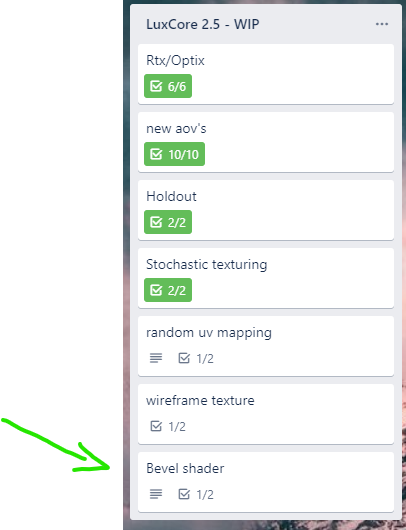

I intrude into the discussion, wasn't the shader bevel expected to come in version 2.5?

JulianoLisboa wrote: Wed Mar 03, 2021 5:23 pm I intrude into the discussion, wasn't the shader bevel expected to come in version 2.5?Bevel Shader.png
The work is going on this (v2.6) branch: https://github.com/LuxCoreRender/LuxCor ... geom_bevel
