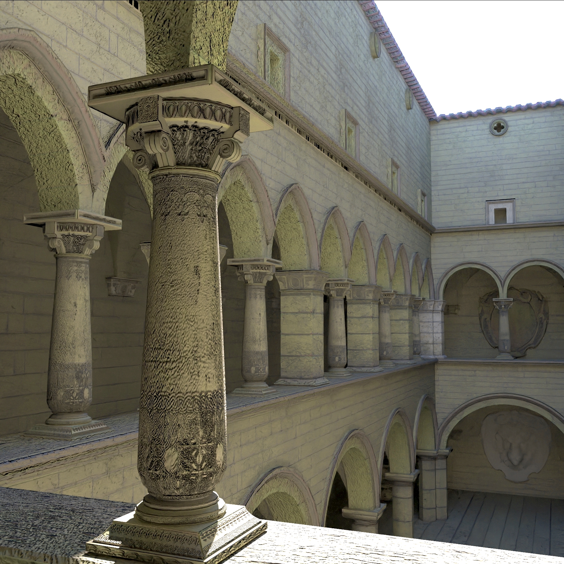

the famous sponza scene, I used glossy 2 to render the whole scene.. bitmap texuteres for diffuse, specular and bump. rendered for just 389 samples..
both rougness set to 0.98
patro wrote: Thu Feb 18, 2021 10:39 pm
TAO wrote: Thu Feb 18, 2021 8:29 pm The bump on the image is very nice.
Well done, i think the bump map on the columns still needs a little bit of work.

about the render, what you see is the original render, I saved as jpg, I just added 0.5 gamma because it was saved not gamma corrected from 3ds max
about the bump texture i've used the blueish one as bitmap dragged into the bump channel
as you know there is no way to control the scale of the texture, but using the greyish one is the same.
