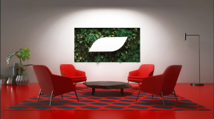

Hello,
I have a scene similar to the photo below and I was wondering about the way to achieve this lighting setup. I am interested in the lighting above the logo space in particular, but if you have any tips on how to make the lighting of this entire scene, that will obviously be very beneficial to me.
Thanks for reading,
Cole H
Ohio, USA
How do I achieve this lighting setup? (photo example)

Re: How do I achieve this lighting setup? (photo example)
The easiest way is probably to use an IES light. For example, at this site, you can find literally thousands from some different real-world manufacturers.
You just need to browse the library and look for one that suits your needs.
Martini-
Thank you thank you thank you. The exact thing I was searching for.
Have a wonderful day,
Cole
