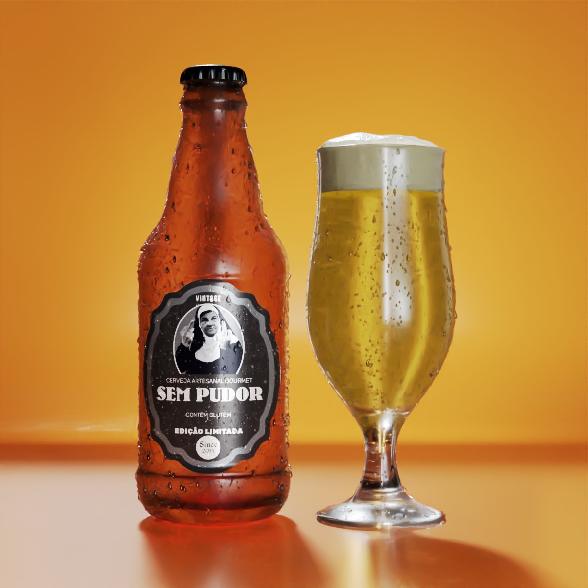

Hello dear friends, I am actively using luxcore in my work, I am a packaging designer and I do a lot of product shots. I used the 3ds Max and Corona for many years for that. Since I switched to Blender I am very happy, but I have always been looking for a renderer that has real caustics, so I found the luxcore.
Well, I don't speak the English language (I'm Brazilian and I only use the Google translator), so what I learn from Luxcore is much more in observation than understanding the concept, and for video tutorials on Youtube I'm having a lot of difficulties.
I would like help from friends here in studio and packshot scenes like these that I will post. I would like to speed up the rendering time to the maximum without losing quality. I have found my renders blurred after using Denoise, I have already used OIDIN and now I have tested AI Super denoise 2.6.
I don't quite understand the render settings or caches, I don't know when to use one or the other.
My configuration is Intel 8700, GPU 980 GTX 32gb RAM, I'm using blender 2.91 and Luxcore 2.5
I am so grateful for everyone's help and patience.
Hugs
P.S. I will send the images and files, first the image made in cycles and then in luxcore and then the blend file.

Aside from clamping (150) and aggressive adaptive sampling (0.95/8/8) + higher refresh interval. I don't think there is alot to get. maybe reduce your specular and glossy deph(this can cut some nice internal reflection inside the glass cup).

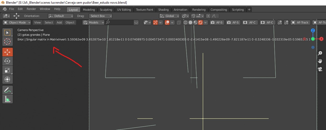

Hello friends, following Sharlybg's tips, I made some adjustments, but I went to fix the drops and now I get this error from MatrixInvert and it doesn't render anything. What can I do to fix it?

"Matrix invert" is an error you may get when the "Up" direction (aka vector) and the looking direction are exactly the same, there may be something wrong in the camera you are using.

I deleted the camera, created another one and the same error happens.

It may be also the matrix transformation of some object set to some odd value (like a 0.0, 0.0, 0.0 scale).

Can you post the scene giving the error ?

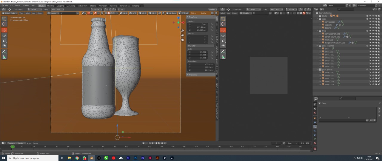

Post by JulianoLisboa » Tue Jan 26, 2021 3:20 am
follow the link to download
https://drive.google.com/file/d/1EjRRZG ... sp=sharing

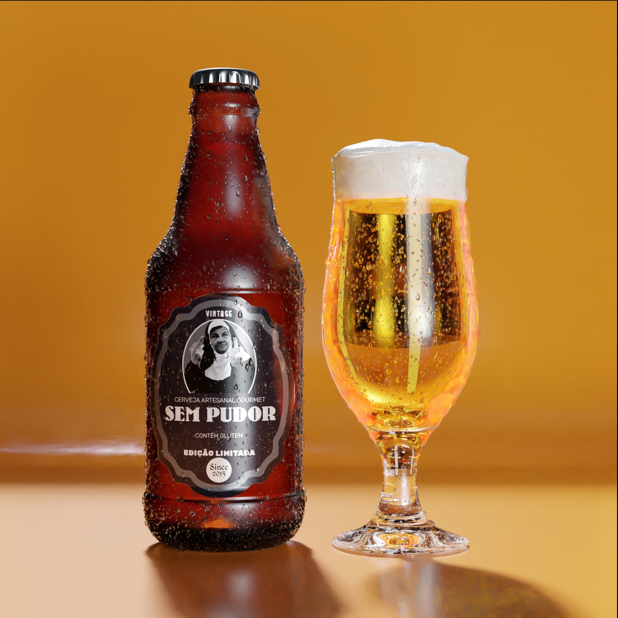

Here's a quickie...
There were few more issues in the scene. Study changes by comparing ;)
And I'd still want to resolve couple of things, but got other priorities.
Do good & Be well.
vopidobrazil.blend (54.3 MB @ wetransfer)
