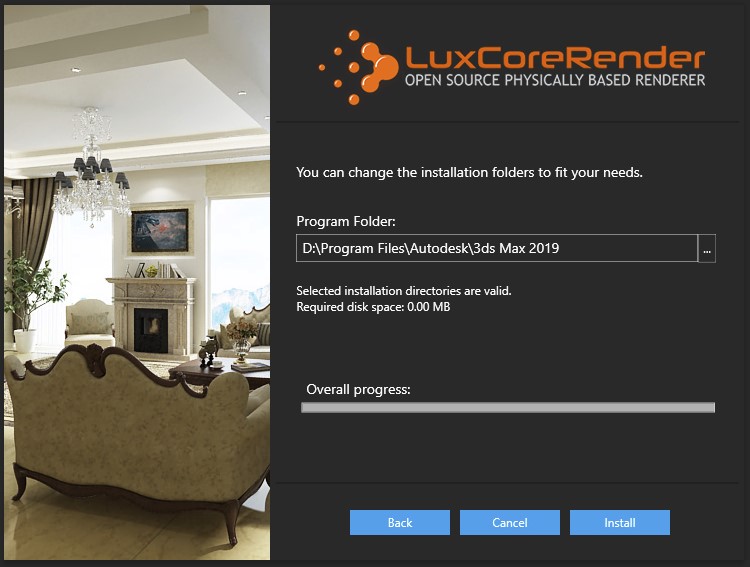

Sharlybg wrote: Thu Jan 14, 2021 12:21 pm It look refreshing and very nice. Will be even better with a more finished and polished background render ;) (maybe your last livingroom render)
Yes, absolutely.
I Changed the image and make a few changes in UI.
I'm a beginner in Wix Toolset and it's a bit painful to work with the interface.
Maybe this one is better, not quite sure.
Also, I still have a little bit of problem to make the installer work for multiple versions of 3dsmax, as I change the plugin type and dependencies it is possible now to install MaxToLux on several 3dsmax at the same time with just one installer and smaller size. but It needs more work on the Wix side yet.

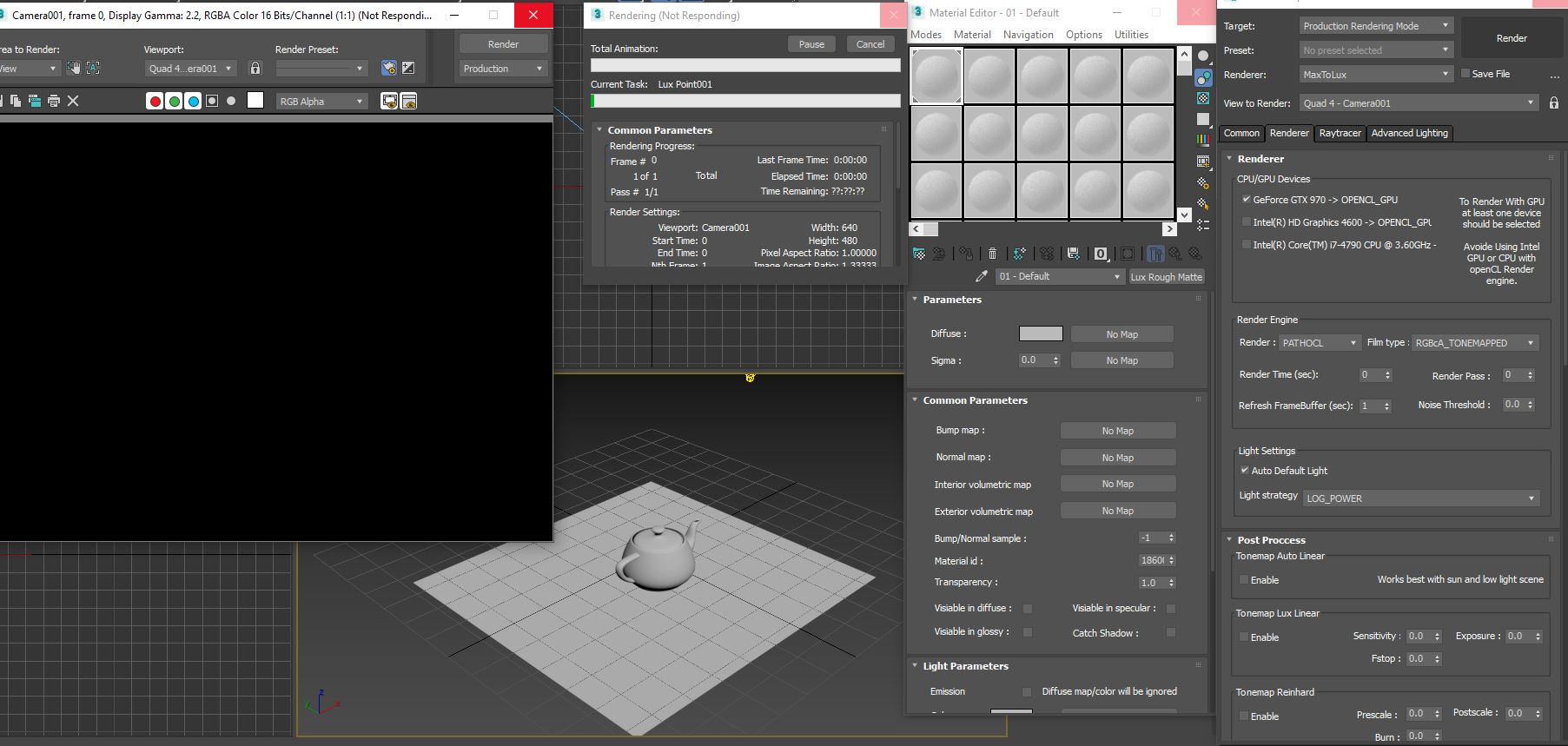

Hi, for me PATHOCL in any of the demo scene or other scenes it dont work at all :C i have a gtx 970
That's taking too much time because you have an intel GPU OpenCL install. in my advice remove the intel HD 4600 drive and it will fix the issue. Also, your computer will run faster.
Try it and let me know.
I will fix that to ignore any intel GPU very soon.
