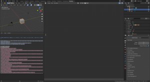

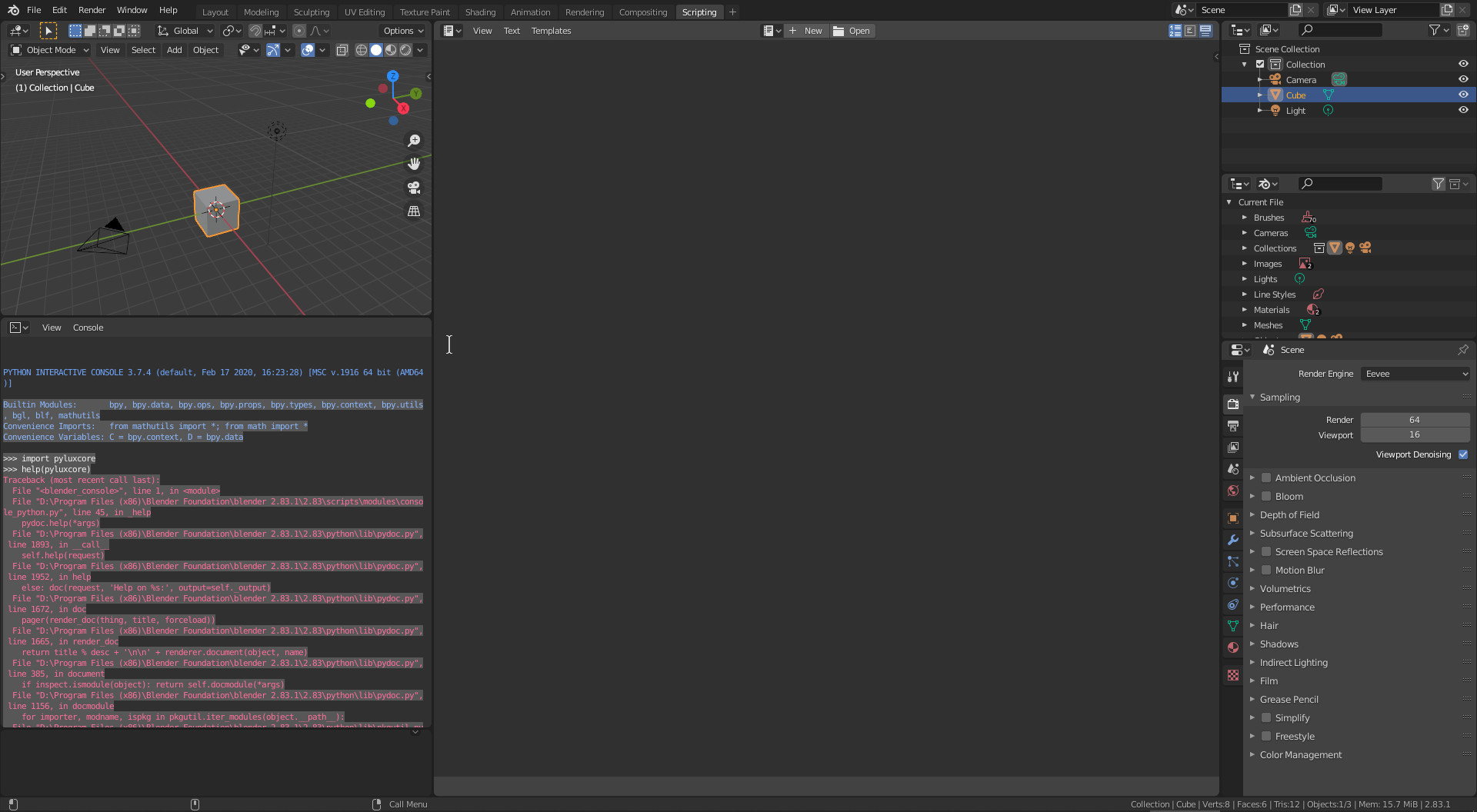

What I'd done was to copy the files from C:\Users\Jan\AppData\Roaming\Blender Foundation\Blender\2.83\scripts\addons\BlendLuxCore\bin\ to D:\Program Files (x86)\Blender Foundation\blender 2.83.1\2.83\scripts\modules\ because if not I will only get:
I search online for many hours but still don't know how to set this up properly or whether BlenderLuxcore files at C:\Users\Jan\AppData\Roaming\Blender Foundation\Blender\2.83\scripts\addons\BlendLuxCore\bin\ must be duplicated somewhere? I really like to at least make the pyluxcore_demo.py file work but don't know how. Nothing happend for now when trying to run the copy and pasted script at Blender Text Editor window. Please help and thanks.

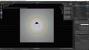

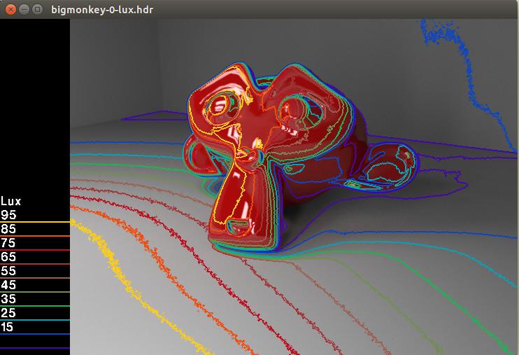

I really like to see the illuminance values along with the illuminance contour in my own designs such as this image.
However I cannot find anything that would allow this except through Scripts in Blender but I don't know how to write one. I copied and pasted the pyluxcore.pxd from C:\Users\Jan\AppData\Roaming\Blender Foundation\Blender\2.83\scripts\addons\BlendLuxCore\bin to D:\Program Files (x86)\Blender Foundation\blender-2.83.1\2.83\scripts\modules and trying to see if I can run this script pyluxcore_demo.py successfully in Blender with BlendLuxCore addon. I read this thread viewtopic.php?t=371 again and found out the module is pyluxcore.so and not pyluxcore.pxd.
My question now is how to make pyluxcore_demo.py and other BlendLuxCore scripts run on Blender as well importantly also making Blender do data visualization along with contour lines?
Thanks!
