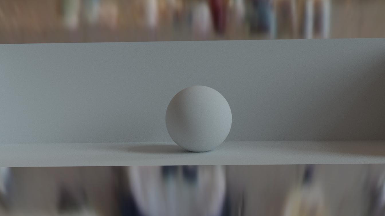

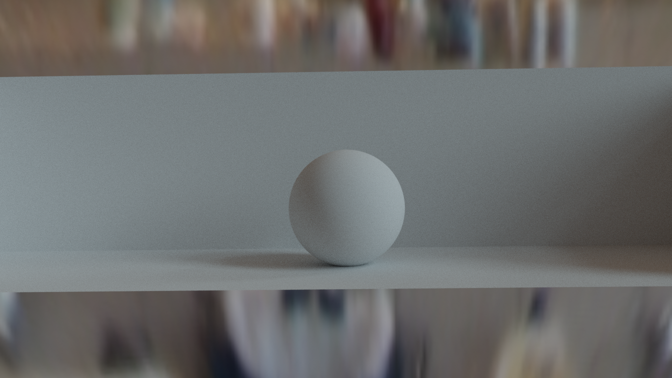

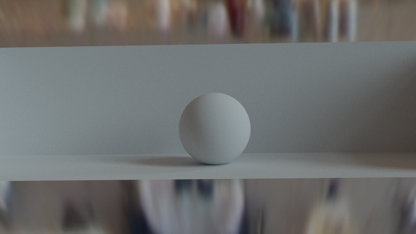

Hello! Maybe i do something wrong but i get very different and less realistic (in my opinion) result when i use PGI cash.
The scene is very simple. All PGI settings i left by defult.
without cash
without cash
with cash
with cash
As you see in this scene PGI gives very dark gradient on the sphere. Is it normal?
I use luxcore 2.5.

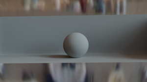

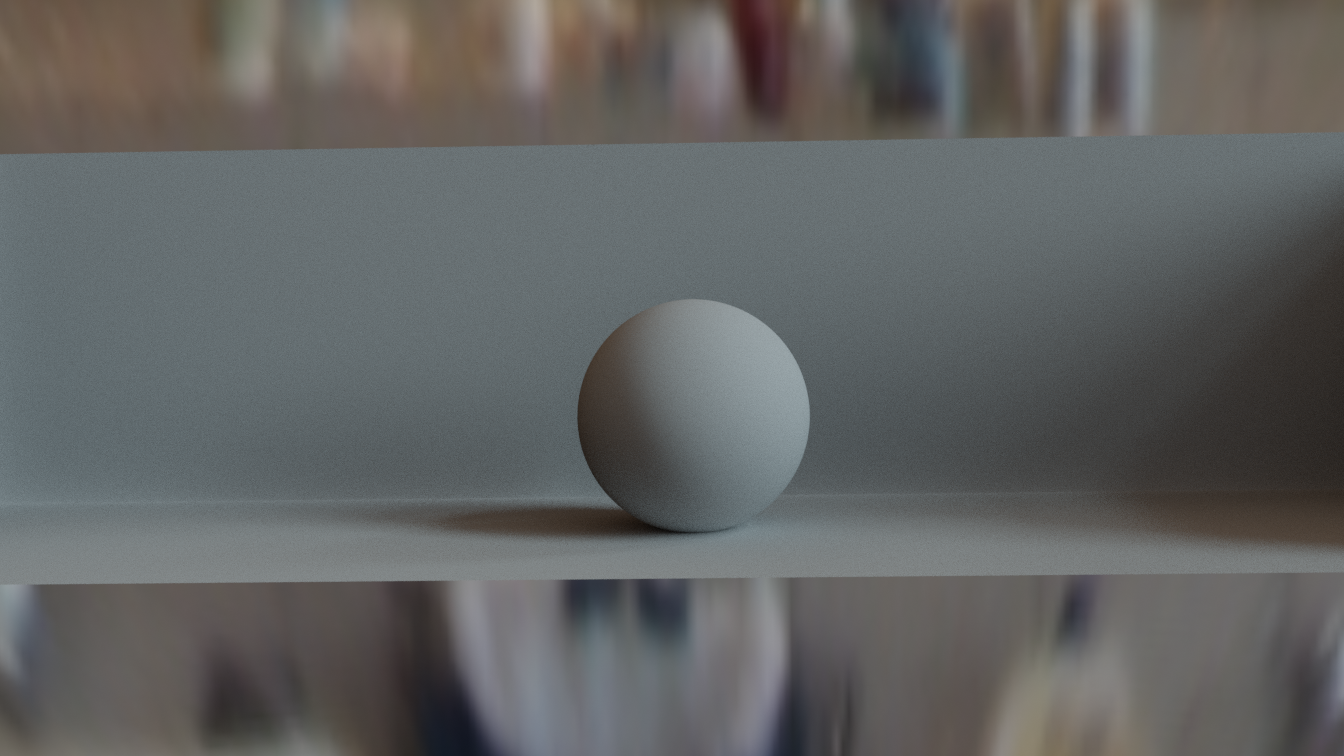

my test
everything is fine
gpu cuda
path
path
PGI
PGI
