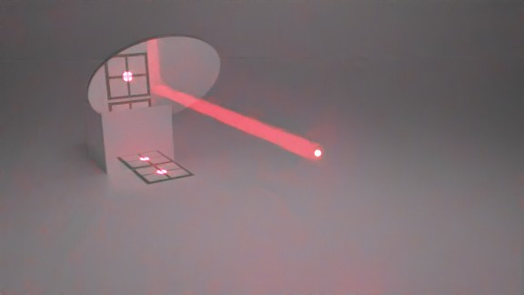

The original image in this thread, made with "bidir", shows a beam being scattered as it travels through the volume (good). It is missing reflections in the mirrors (bad) as shown in the annotations.
Switching to "path" I can see the reflections in the mirrors (good) but no more beam scattering through the volume (bad).
The question is how to get both.

here is what i get (light tracing don't help alot here so it is disable) with path tracing and caustic cache.
moving-mirror7.blend
(1.07 MiB) Downloaded 804 times

Thank you. However, I forgot to mention in my previous post that the scattering should also be visible after the mirror. In your render, it is missing, whereas in the first post it is present.
