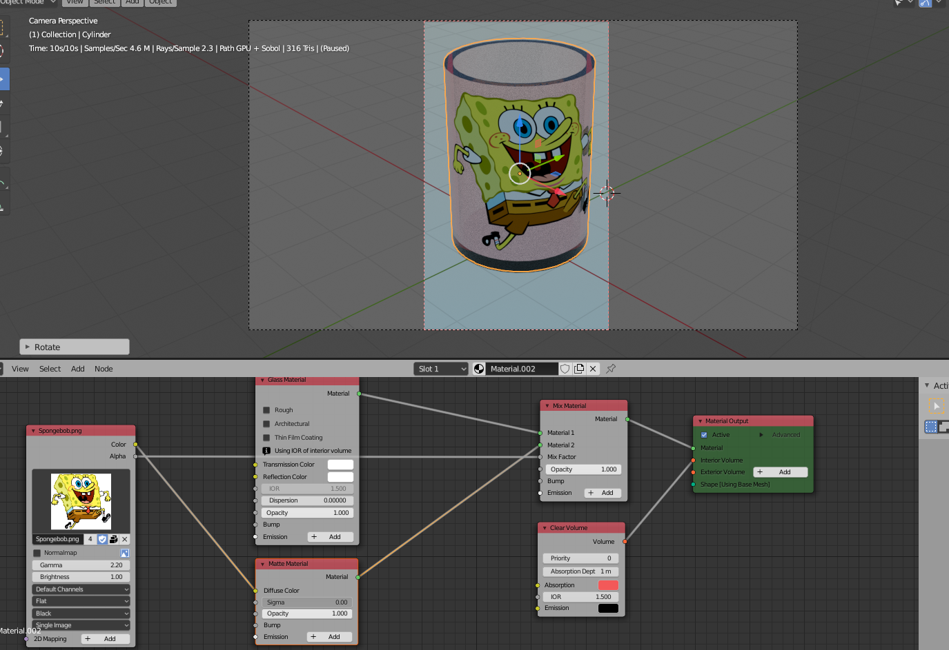

Hello,
I don't know how to use an alpha texture in Luxcorerender
I thought it works like in Cycles ?
Can someone help ?
Thanks
Re: Problems with alpha texture and mix nodes
Looking at the screenshot, you may have to "invert" (i.e. 1 - alpha) the alpha value :idea:
The alpha mask seems the negative of what you want. It should also work if you just swap the mixed materials.

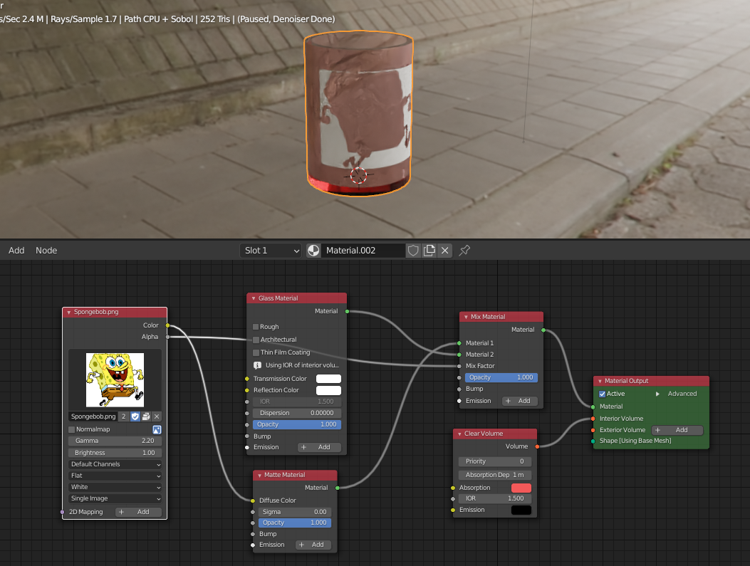

Hi Denon,
Maybe, instead of connecting alpha to MixFactor, you could try :
connect SpongeBob Color -> ColorRamp, setting black Offset to 0.9 in ColorRamp
then connect Color Ramp -> Mix Factor

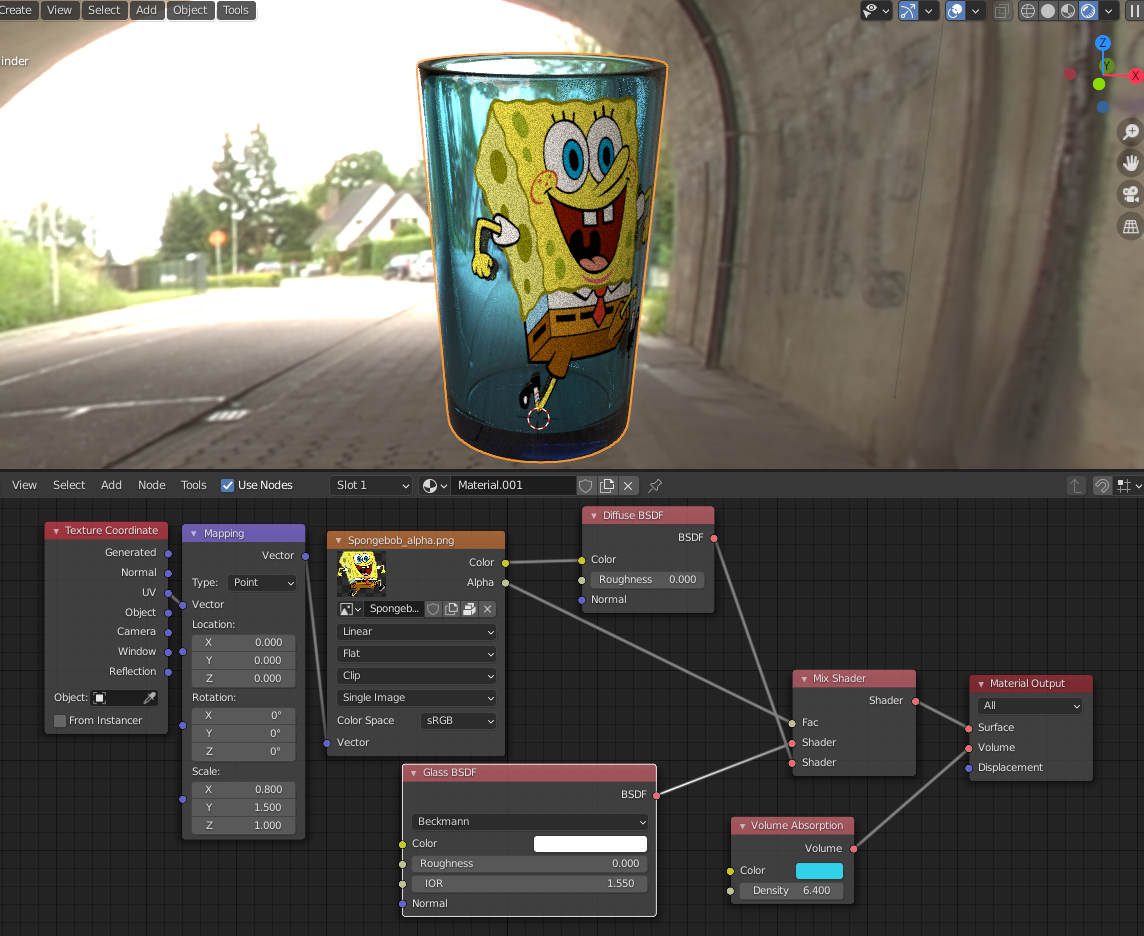

Hello,
this works only conditionally and is not what I want to achieve.
With the user Osmodivs , see link, it also works !
viewtopic.php?f=4&t=2569&p=25335&hilit=alpha#p25335
Thanks
mip
Posts: 8
Joined: Fri May 22, 2020 11:46 am
Post by mip »
I think it's because Osmodivs image has a transparent background while yours has a white background.
You will have to use PetrT way or change your source image.
