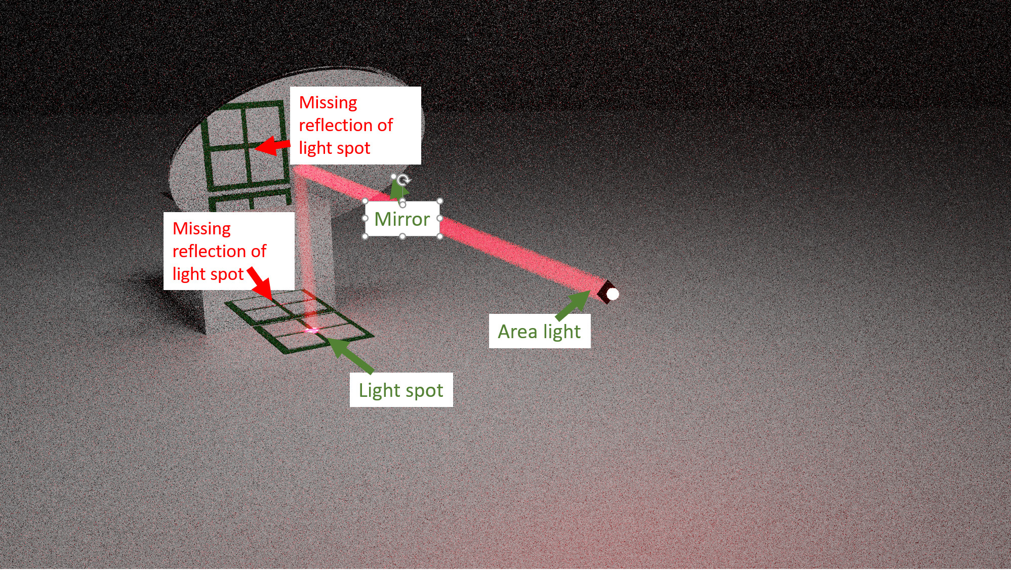

Hi, I'm trying to render a light spot where the light spot is created by a narrow-angle area light shining through a mirror. I can see the light spot directly with the camera. However, the light spot is not visible through the mirror which bounces the beam from the area light, nor is it visible through another mirror. I am attaching a test scene to reproduce this and linking to an annotated image showing the problem. The light spot falling on the objects on the ground should be visible through both mirrors, but it is not.
This is with the Bidir Engine, Metropolis Sampler, 20 Max bounces for both eye depth and light depth, Blender 2.83.20 win64 and BlendLuxCore 2.4 win64.
Is there something I can do to fix this? Or is there perhaps a bug?
EDIT: attached the annotated image directly rather than linking to imgur.
cannot see reflection of light spot

They are called SDS paths (Specular-Diffuse-Specular) and they can be rendered only by using PhotonGI caustic cache. Normal BiDir can not render that kind of light path at all.
It is a feature introduced in v2.2:

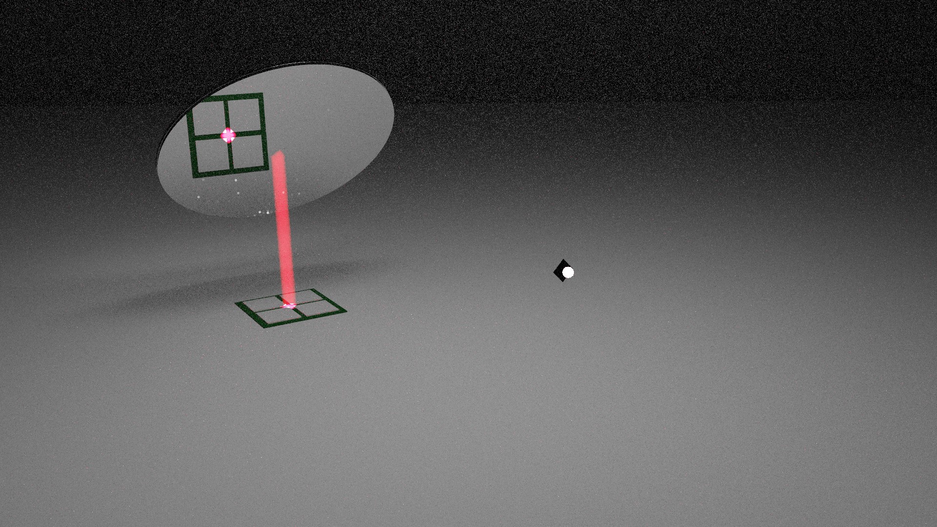

Thanks for the quick answer. If I use the PhotonGI cache and normal paths (not bidir) I get a different problem - I do not see any scattering from the volume (which is weakly scattering) immediately after the area source but before the narrow beam bounces off the mirror. I am attaching an image showing the problem. There should be a red beam going horizontally from the mirror to the small sphere.
Is there a way both to get the reflected light spot as well as the scattered beam in one image?

The scene is probably incorrectly built: you need to set materials outer volume or world volume. Like: https://github.com/LuxCoreRender/LuxCor ... -745247191strawman wrote: Sun Dec 20, 2020 7:35 pm Thanks for the quick answer. If I use the PhotonGI cache and normal paths (not bidir) I get a different problem - I do not see any scattering from the volume (which is weakly scattering) immediately after the area source but before the narrow beam bounces off the mirror.
