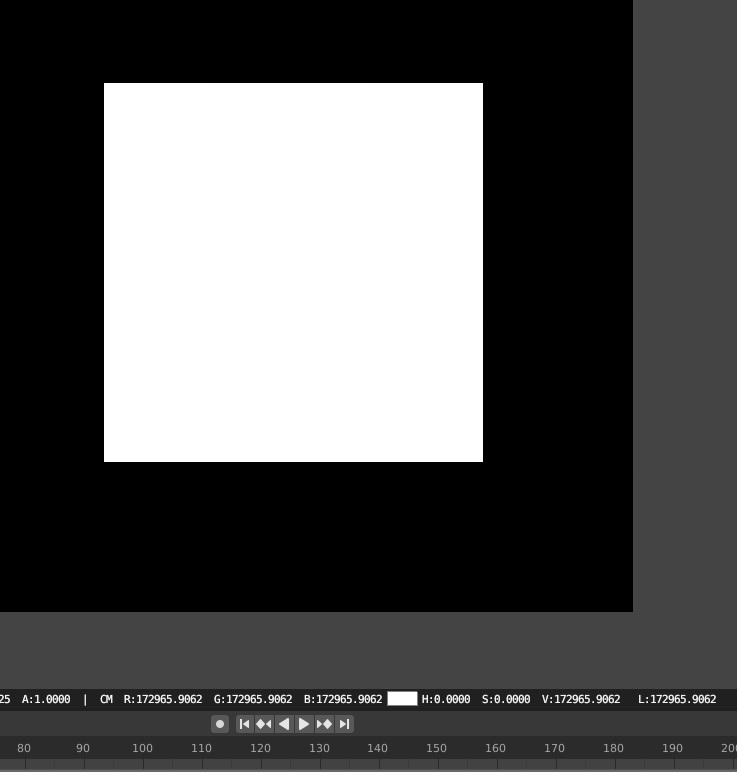

Hello all,
This is the test condition:
A light emitting surface with edge length of 1mm x 1mm emits 1 lm of light in an lambertian way.
This is observed by a camera very far away (infinte) normal to the light surface.
Theory says:
luminance = luminous flux / solid angle / projected lit up area
luminance = 1 lm / pi (solid angle of lambert emitter) / 0,000001 m^2
luminance = 318310 cd/m^2
Luxcore result is 172966 cd/m² read from Blender...
I validated that with a professional software that reads *.exr files. It gives the same numbers as Blender.
A simulation with that software confirms the theoretical solution.
This is my test file:
Luminance_1.blend
(812.47 KiB) Downloaded 438 times
Please let me know your thoughts about that.
Thank you.

The difference seems to come from this line of code, where BlendLuxCore converts lumen to watt: https://github.com/LuxCoreRender/BlendL ... ht.py#L741
Let's calculate the factor: 2*pi*(1 - cos(90°/2)) = 1.84030,
as well as the ratio of your results: 318310/172966 = 1.84030 :arrow: the same.
I might be wrong becauseI always found this topic of luminous units confusing, but I came to this conclusion: I believe there was a mixup in the BelndLuxCore implementation, i.e. confusion between luminous flux (measured in lumen) and luminous intensity (measurd in candela).
Luminous flux is a measure of power weighted by the response of the human eye, which is a function of wavelength. Because LuxCore assumes the theoretical maximum of 683 lm/W, the two should just be equivalent. (And the equation used now actually exports Candela, not Watt).
P.S. 1: the equation should have used cos(spread_angle), not cos(spread_angle / 2), because spread_angle is already defined as the half angle.
P.S. 2: The same equation is used a few lines above in conversion from power to power: https://github.com/LuxCoreRender/BlendL ... ht.py#L731 :?:
P.S. 3: I'm wondering if, in LuxCore, "efficiency" should be divided by the same factor 683 https://github.com/LuxCoreRender/LuxCor ... l.cpp#L165
