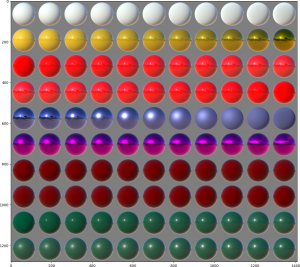

I am continuing here from this thread. I have tried to recreate the demo plot from the 2012 paper. This is the closest I have come by now, using the most similar HDRI I found:
But it is difficult to know if it corresponds exactly as they don't mention what the other parameters are...
What I do observe is that the "Fresnel-halo" is very pronounced in LuxCore. Exemplified also by a specular halo that is presenent with the base color set to black:
So my second question besides that at the top: Does anyone know of any more references for how the Disney material is supposed to look?
