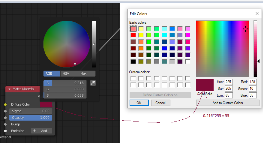

I want to convert standard RGB color (0-255 range) to LuxCore 0-1. I was trying to simply divide by 255. But the color I get in the render is completely different. Than I have made some simple test using Blender. A set some random color make print screen, copy to Paint, make a color pick and I got completely different values. So the color is the same, but Red is 0.216*255 = 55 but Paint is giving me 128.
So my simple question is. I have a color (128, 10, 55). Ho to convert the values to LuxCore system?

Or maybe I have a wrong approach. It looks like blender is applying gamma correction about 2.2 to color conversion ( (x / 255)^2.2) gives quite similar results.
Maybe I simply should divide color by 255, and set gamma in image pipeline to 1.0. The only thing I want to do is to get the same color on render that I set is scene setup.
