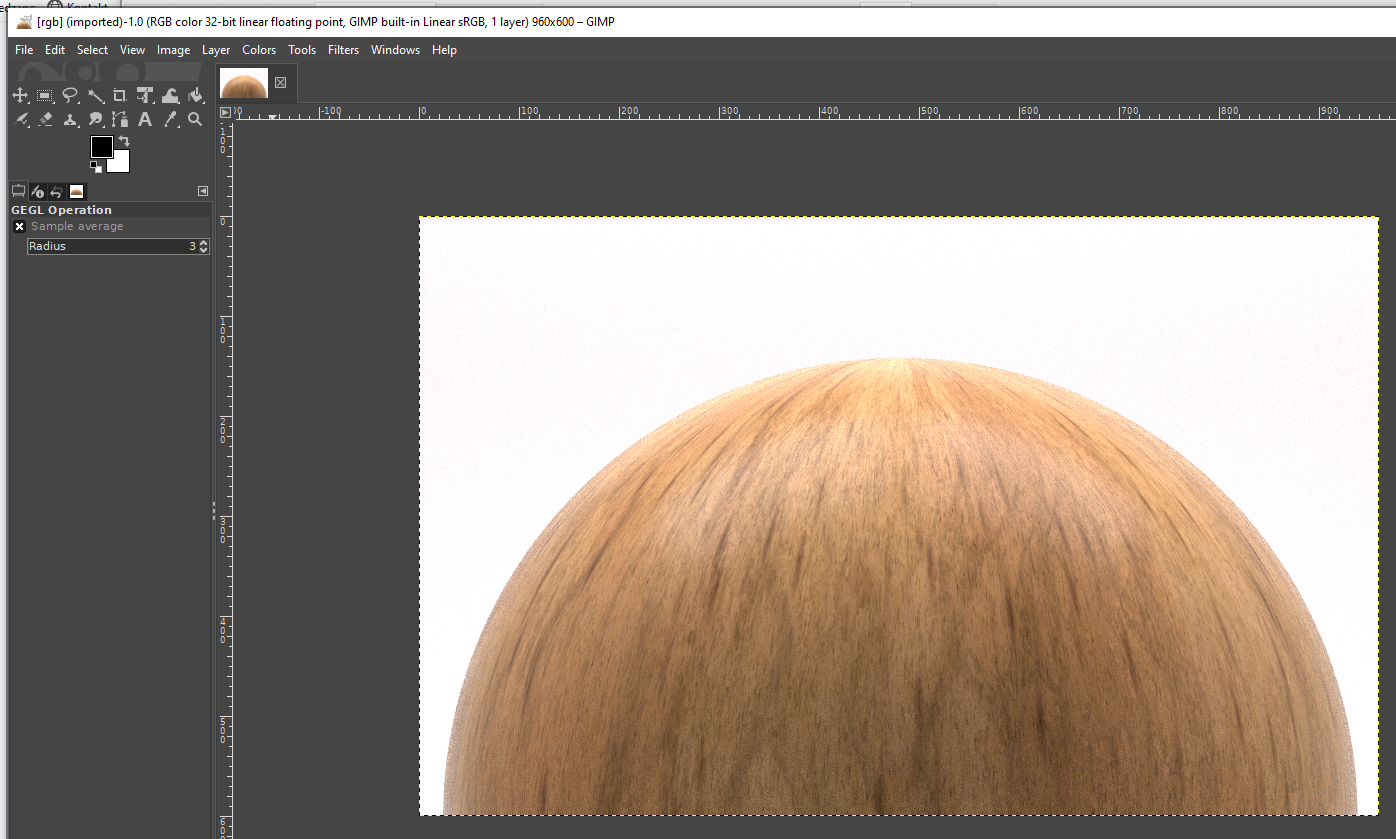

I have defined multi pipelines as you asked.
So the image rgb_g22.png is my reference one. This is how the render should look like.
Than I have 2 exr files. One with gamma 1.0 another with gamma 2.2. If if open them with gimp neither of them lool like png file, but they should.
I mean. The exr with gamma 2.2 will not be correct, as gimp applies gamma correction 2.2 wile opening exr files. So in this case we have to times 2.2 gamma applied. But with rgb.exr (that has gamma 1.0) opened with gimp that applies gamma correction 2.2 I should see exactly the same result as rgb_g22.png.
I can not attach exr files so I send screens of this files opened with gimp.
