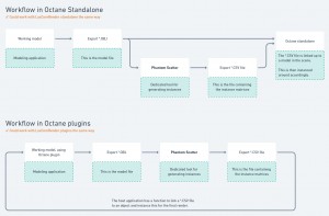

Workflow looks like this:

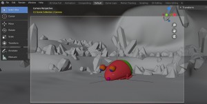

Scene in Blender:

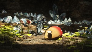

Scene in Octane standalone + scattering:

I suggest you to focus only on the second scenario: LuxCoreRender standalone is intended as a sample to show developers how to use LuxCore API. It is not really intended for end users (and it is not used by 99% of them).
It may be useful for testing/development but it doesn't make sense as target for a commercial product.

I agree only scenario 2 is viable, since LuxCoreRender doesn't have a standalone dedicated UI. I did want to explain both to make myself clear.
