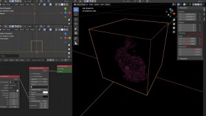

i download the bunny cloud vdb here https://www.openvdb.org/download/

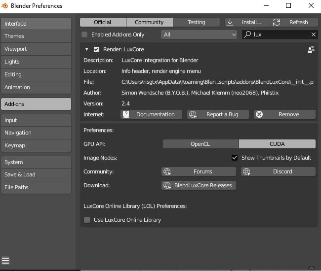

using luxcore 2.4 and blender 2.83.8
followed the tutorial here by Michael Klemm
https://www.youtube.com/watch?v=Bim5S7g ... 2G&index=3

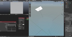

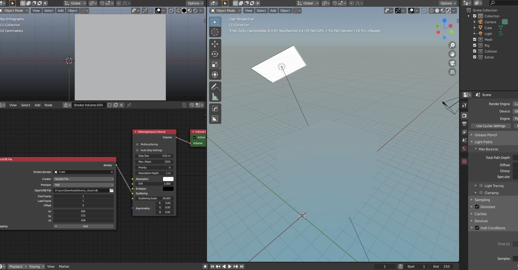

there is no "use bounding box offset" option here and the cube is not showing the bunny
blend file attached.. what's wrong in my setup here

Win 10 64bit, Ryzen 5, GTX 1060 6gb, Luxcore 2.4, Blender 2.83.8

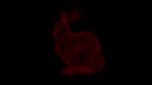

found the problem,
tested with Blender 2.83.9 and it works, it seems that the scale of that bunny is soo small
now i just have to find how to export that density attribute from houdini
