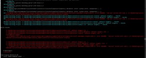

I'll attach it as an image that is perhaps more readable:
Any ideas please?
