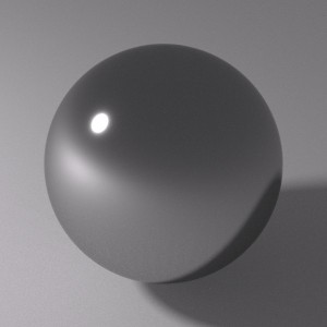

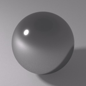

When trying to render a scene with LuxCore using the Bidir Engine and Metropolis Sampling... A Light cutoff artifact appears on a Diffuse Background Surface visible in a specular reflection.
I made a comparison render with the Path Tracing Engine and it shows no problems.
Light Paths > Clamping -- is not enabled in the Render Properties.
There are two pictures one with Path Tracing and one with Bidir + Metropolis. To see the difference more clearly it is best to Download the images and flip back and forth between them. Also There is a matching Blender scene attachment.
To me It looks like some kind of a light cutoff threshold problem.
What is it actually? How can this be fixed?

Path Tracing - No Problem
Bidir Metropolis - Circular Light Cutoff at the top

Marko Posavec wrote: Tue Nov 10, 2020 1:02 pm What is it actually? How can this be fixed?
Your scene has a max. path depth of 5+5 (eye path depth + light path depth) with BiDir: the longest path traced will include 10 bounces. While your Path tracing max. depth is 5 (path tracing only trace eye paths).
BiDir traces longer paths and transport more indirect light so the result is brighter.
BTW, I don't know if you are aware but you are using 228 light sources (the 228 triangles of the bright sphere): it is very very inefficient and a bad idea in general.

:arrow: I'm not sure if you are understanding what my problem is.
Do you see a circular shading artifact on top of the sphere when using Bidir + Metropolis render?
I tried everything you suggested and still the artifact is there, even after using a point light instead of the meshlight.
Radius and power are the same, still the artifact persists.
Is this a problem with the render engine or am I doing something wrong?

Marko Posavec wrote: Wed Nov 11, 2020 12:27 pm :arrow: I'm not sure if you are understanding what my problem is.
No, I didn't, I see now the top circle artifact reflected on the sphere. I will check. It may be some kind of precision/limited color resolution problem: your "room" is a sphere too and normal interpolation may be a problem (for instance, does it happen with a cube too ?).
I did not test with a cube precisely because I suspect that the "threshold problem" could "get stuck in the corner" and be very difficult to tease out if you know what I mean. This was the simplest scene I could come up with to demonstrate the problem as clearly as possible. My original scene used a cylinder instead. A similar problem happened with the cylinder as well.
