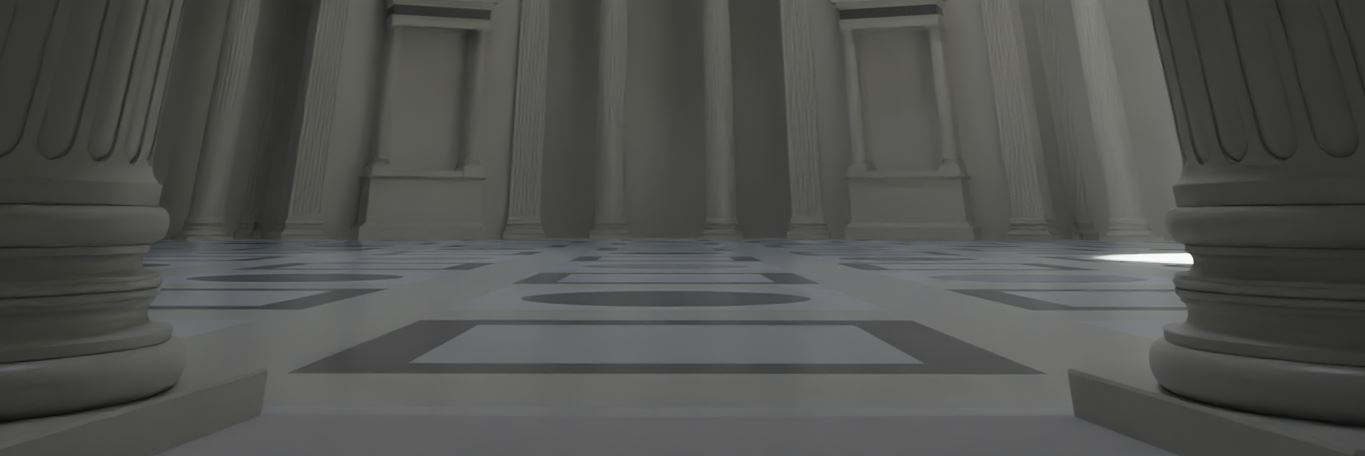

sure.
ground truth (no cache, PT only)
Re: Very long wait for caches enabled
You can try to raise the brute force radius scale, but this will lower rendering performance because the cache will be used less (over the whole image).
Or you could disable cache usage for the floor (in the material output node advanced settings).

B.Y.O.B. wrote: Thu Nov 12, 2020 8:59 am You can try to raise the brute force radius scale, but this will lower rendering performance because the cache will be used less (over the whole image).
Brilliant idea! Thanks.

Dade wrote: Thu Nov 12, 2020 9:37 am Do walls have thickness ?
no, they don't actually. Is this what causes it?

Likely, you can have light leaks due to numerical precision (or too large cache entry conditions like normal angle, etc.) in that case.
Note that you don't have to add a solidify modifier to the walls if that generates too many new polies, you can also just put boxes behind the walls to block the light.

After trying blocking volumes, thickening the floor, setting face smoothing to flat.. in the end what resolved it was changing the wall geometry so that part of it did not intersect with the floor geometry. Intresting to know. Will avoid this in future.
