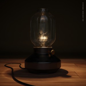

Hey folks,
here is my first luxcorerender with only one light, rendered in Bidir mode. comments welcome greets André
Re: Blender Luxcore "Light in the dark"
Nice detail on the glass.Any reason for not taking path + light tracing ?
gandre82
Posts: 11
Joined: Sat Nov 07, 2020 12:15 pm
Post by gandre82 »
simply because i get better results, i append an image rendert wie lightpath and i thinks this not works.
due the fact that i have one light i have activated the dlsc for bidir.
if i render the same scene with path, settings not changed i get this result-> attachment. no light(in bulb, no good reflection. its curious maybe i m doing something wrong in lightpath mode.
greets andre
addition: i tested a bit, and it seems that the light not travels through the big-glas-bulb.
You're using path without light tracing so it is hard to get the light rim. Also how about your light bounce settings.
gandre82
Posts: 11
Post by gandre82 »
hey ho,
lighttracing is enabled, my bounce-settings are all the way up to 12 on dif,glos and spec. photonmap on 20-bruteforce on 8 caustics cache is also enabled. the results are so strange compared to bidir. this is fukn me up...
Posts: 821
gandre82 wrote: Sun Nov 08, 2020 1:06 am hey ho,
... this is fukn me up...
oi,
just brighten glass shadow color in material output
gandre82
Posts: 11
Post by gandre82 »
kintuX wrote: Sun Nov 08, 2020 11:46 am
oi,
makes no difference i tried this shadowcolorthing already.
One thing i discovered, of i disable all glasselements i get this lightrim. So i think the failure is in lighttravelling.
gandre82
Posts: 11
Post by gandre82 »
pathtrace-update!
i reassigned a new fresh glass material, and i get this lightrim. as far as good.
now i tick the rough-box in the shader, because i what to add some dirtmap on the glas, and the lighttravellin is gone no matter what value 0 -10. i think this isnt right. try it for yourself.
if i now switch to bidir, it renders correctly. maybe shader-bug?
gandre82 wrote: Sun Nov 08, 2020 12:47 pm pathtrace-update!
increase the glossiness treshhold of the lightracing until you get the light rim.
gandre82
Posts: 11
Post by gandre82 »
Sharlybg wrote: Sun Nov 08, 2020 1:16 pm
well, it can be so easy! this works! thanks, now i can sleep well!
