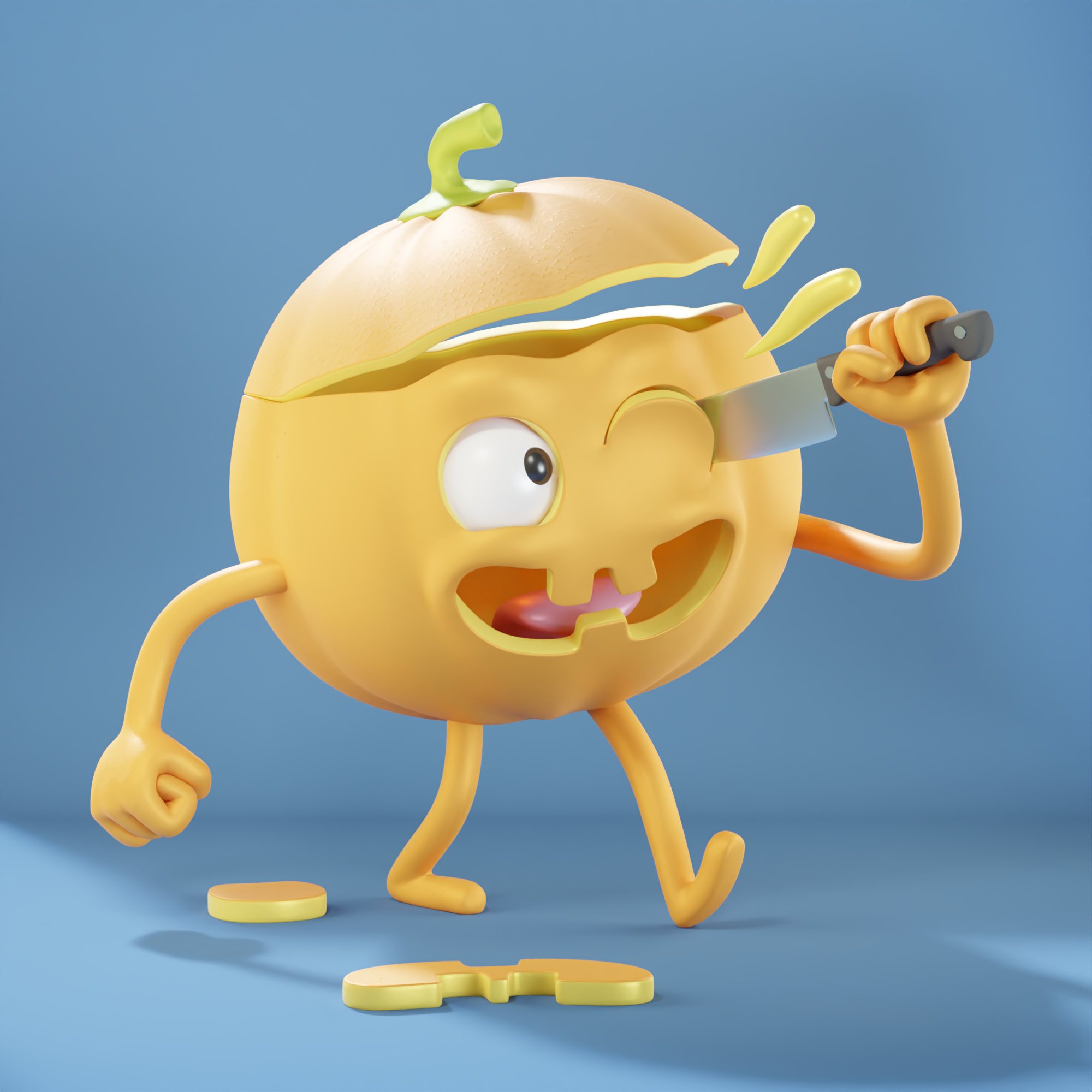

This is my final SSS material setup in the pumpkin scene:

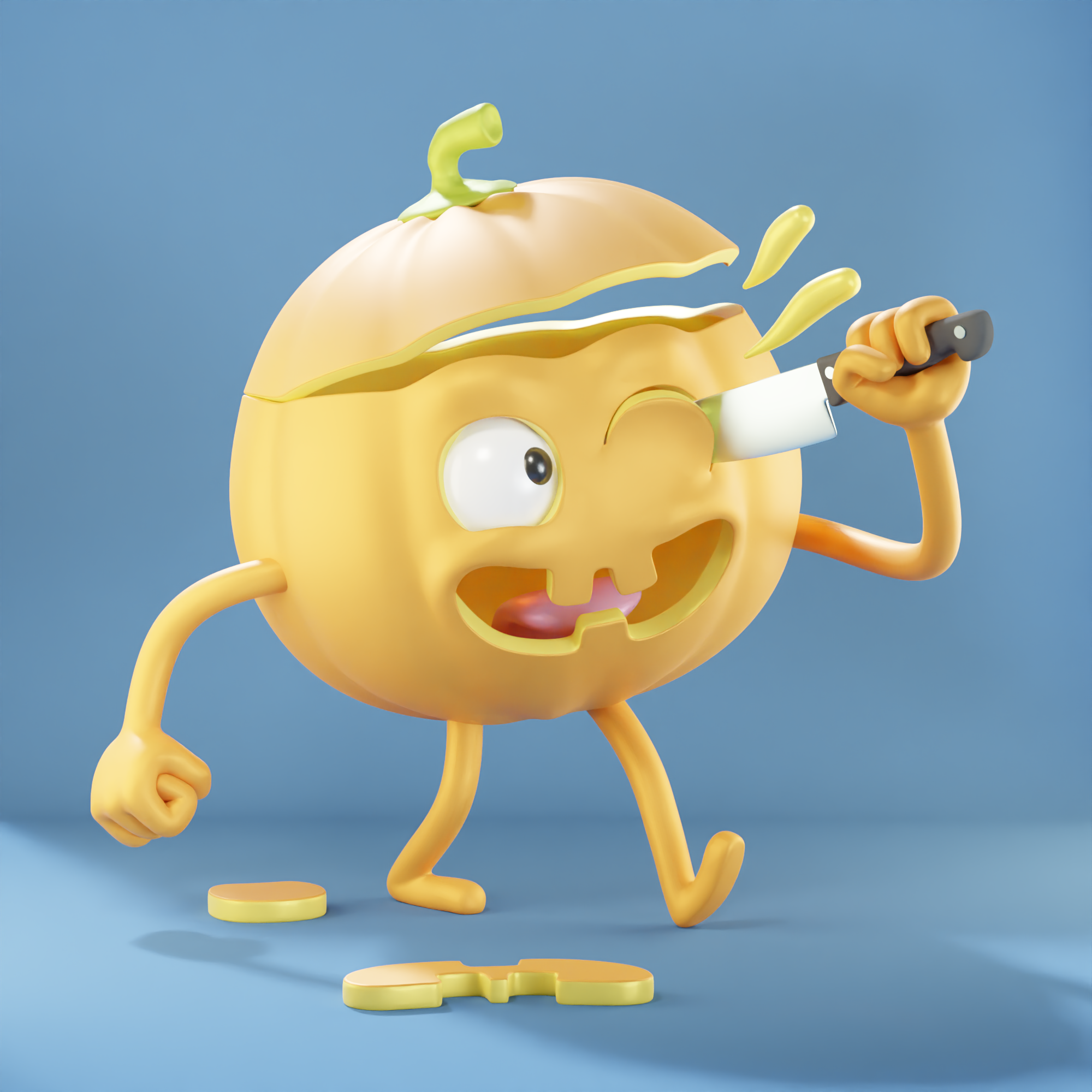

But, very interestingly... I decided to switch from Path + Sobol + Light Tracing + Photon GI Cache + Caustic Light Cache to Bidir + Metropolis, just to see if there would be a noticeable difference. It turned out there are quite some differences:
I think Bidir + Metropolis looks noticeably better, and not only the SSS, also the metal shader of the knife looks a lot better.
I've been using Path + Sobol + Light Tracing + Photon GI Cache + Caustic Light Cache because of the SDS paths, but I guess I'll return to Bidir + Metropolis. Would it be possible to accelerate Bidir + Metropolis using the GPU?

what purpose do you pursue by uploading such huge images to the forum? They are simply too lazy to wait when they open in full size.
I also like the metal of the knife more in the version with BiDir

Dez! wrote: Thu Nov 05, 2020 9:30 am what purpose do you pursue by uploading such huge images to the forum?
Haha, no purpose. Just forgot to convert them to JPG. :)
It seems that all specular highlights are more prominent in the Bidir + Metropolis rendering, and the SSS also is a bit lighter, with a more gradual falloff.
Wonder if the caches and light tracing is helping anything here ?

I just figured to activate all settings that bring the Path engine closer to the Bidir + Mis result, for the best quality. But it turns out that Bidir + Mis still has the edge.

Bidir + Metropolis can't do SDS caustics, so at least the Caustics light cache would be an "advantage" for Path. I'm also with Sharly as in I don't even see any obvious SDS paths there. Maybe in the knife reflection onto the pumpkin-eye carving, but there is only diffuse lighting arriving there.
Also again threre seems to be a systematic difference between the two images: I can't see the bump(?) texture on the skin? Did you make any other changes than just the render engine?

CodeHD wrote: Thu Nov 05, 2020 9:58 am Bidir + Metropolis can't do SDS caustics, so at least the Caustics light cache would be an "advantage" for Path. I'm also with Sharly as in I don't even see any obvious SDS paths there. Maybe in the knife reflection onto the pumpkin-eye carving, but there is only diffuse lighting arriving there.
Yeah, I guess the SDS caustics are only apparent in specific scenarios with visibly transparent materials.
No, but good point about the bump map. It turned out I need to set the bump effect to a more prominent value when using Bidir + Mis.

I'm wondering: is Bidir + Mis not able to render SDS paths at all, or is it able to do so if the light has some area or volume? (Not a distant sun or point light.)
