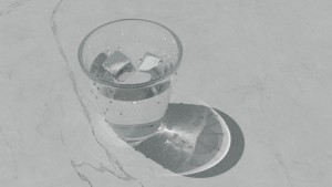

How would I create something that looks like this:
Re: Rendering
A nice tutorial themeHow would I create something that looks like this:
