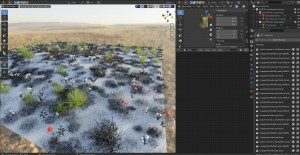

My attempt to render Quixel assets with Cycles shaders, which isn't complex (same with Scatter addon assets), Log says about lack of basic operators:

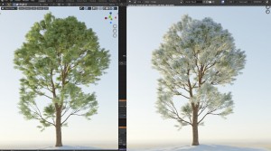

Here i get different result at preview and final render, when i tried to render tree with simple cycles translucent material.
Left is correct result in viewport rendering, right is final render, i tried to play with different settings but result remained the same (both Lux, cuda+cpu):

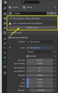

In the scene lighting i can't see and use HDRi managers like Gaffer and ProLighting addons, i don't see any reasons they have to be disabled if i use Cycles settings for Luxcore:

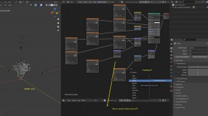

Also in my opinion i would prefer to use single shader editor, if it possible, for both Cycles and Lux, because if material translated wrong i could just put maps into Lux shader, but now if asset has a dozen of maps to find them manually and put into new lux shader it takes a lot of time:

This last part if possible can be really time saving.Also in my opinion i would prefer to use single shader editor if it possible for both Cycles and Lux, because if material translated wrong i could just put maps into Lux shader, but now if asset has a dozen of maps to find them manually and put into new lux shader it takes a lot of time:

We have already added some of the math operations, see https://github.com/LuxCoreRender/LuxCore/issues/118
But almost none of the color operations were implemented so far.
You can see what Cycles nodes are supported here: https://github.com/LuxCoreRender/BlendL ... issues/272
https://github.com/LuxCoreRender/BlendLuxCore/issues
Your points are valid and we are aware of them, it just takes time and effort to make them happen.
The problem with these "basic operators" is that there are just so many of them, so it takes time and effort to implement support for all of them.Nicknroll wrote: Fri Oct 23, 2020 10:48 am My attempt to render Quixel assets with Cycles shaders, which isn't complex (same with Scatter addon assets), Log says about lack of basic operators:
Please open an issue on github and upload the scene so we can try to reproduce the problem.Nicknroll wrote: Fri Oct 23, 2020 10:48 am Here i get different result at preview and final render, when i tried to render tree with simple cycles translucent material.
This is not our responsibility. You will have to contact the authors of these addons, and they will have to enable the panel in this case.Nicknroll wrote: Fri Oct 23, 2020 10:48 am In the scene lighting i can't see and use HDRi managers like Gaffer and ProLighting addons, i don't see any reasons they have to be disabled if i use Cycles settings for Luxcore:
This is planned: https://github.com/LuxCoreRender/BlendL ... issues/362Nicknroll wrote: Fri Oct 23, 2020 10:48 am Also in my opinion i would prefer to use single shader editor, if it possible, for both Cycles and Lux, because if material translated wrong i could just put maps into Lux shader, but now if asset has a dozen of maps to find them manually and put into new lux shader it takes a lot of time:

Is the translucent bsdf supposed to work? For example a Cycles mix shader between a Principled BSDF and a Translucent BSDF?
Just like Nicknroll, on trees for example, I'm having white leaves when Luxcore tries to read it.
