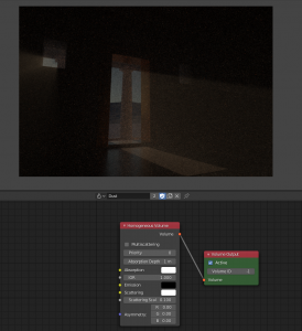

Hi B.Y.O.B! Thank you, I originally followed this video tutorial: https://www.youtube.com/watch?v=PrHWwH_ ... u.be&t=356
DId not work. So I did what you suggested, null box, interior volume called 'dust', and then camera with volume dust. Still not working.
I have uploaded the scene and wondered if you could please have a look and tell me what the heck I am doing wrong?
http://www.archaeological-reconstructio ... ation5.zip

Re: Lighting and PBR - The Parthenon
Your scattering scale was set to 0.
It is a multiplier for the scattering color:
total scattering = scattering color * scattering scale.
So setting it to 0 disables any scattering.
Just use a higher number like 0.1:
- Posts: 19
- Joined: Wed Oct 28, 2020 2:39 pm
Ogh, thank you. I swear I tried this! but I might have given a value that was too high. Thank you so much!B.Y.O.B. wrote: Fri Oct 30, 2020 1:46 pm Your scattering scale was set to 0.
