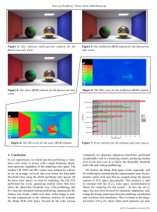

Re: spectral rendering
This statement from light tracer render engine can explain why more often people fail to show the advantage of spectral Vs RGB renderer.
BTW this paper seem to find a less consuming but yet close approach to spectral quality without the penalty : http://www.anyhere.com/gward/papers/PicturePerfect.pdfAt the same time, spectral rendering is most apparent when used with measured spectral data for both light sources and materials. But, in an artist-driven scene, the light source spectra are more usually reconstructed from RGB sliders in some way, leading to very smooth spectra, where it is very difficult to see actual visual differences between RGB and spectral rendering. Moreover, spectral rendering is computationally more expensive and generates more noise. For these reasons, Light Tracer is built on the RGB ray tracing engine.
Nice quote here from first mentionned paper (Picture Perfect RGB Rendering Using Spectral Prefiltering and Sharp Color Primaries) : As we are mainly interested by the look of spectral vs accuracy and considering the size of our team ressources.
This thing deserve a try look at the error level compared to full spectral and naive RGB

They suggest exactly what i said above. They want render a R,G and B Sample and each with the frequency dependent Material values., or reduce
all the spectral data to RGB values and fall back on three
component rendering again.
Then they sum it together. I think that is also what they did with POV-Sample above.
