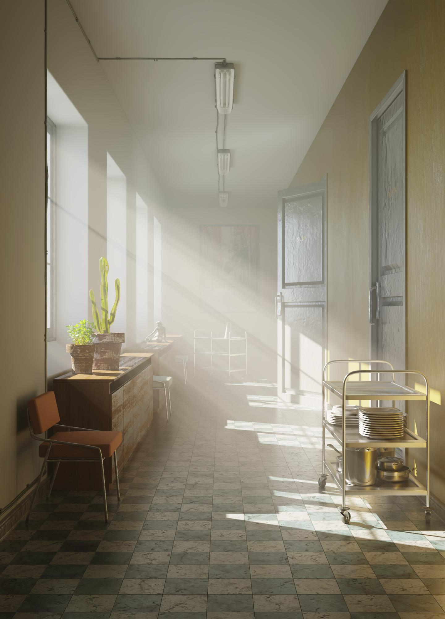

The "HallBench" example scene, rendered with some fog. I also changed the sun angle a bit.
(Scene enclosed in box with null material and internal homogeneous volume, same volume also set as camera volume).
For some reason the doors appear a lot more specular, which makes it obvious that their textures are not high-res enough for this resolution.

B.Y.O.B. wrote: Fri Oct 16, 2020 1:58 pm The "HallBench" example scene, rendered with some fog. I also changed the sun angle a bit.
The original scene can be found here: https://luxcorerender.org/example-scenes/
Author is Sharlybg.
Cool picture, man.
Did you oidin the image? I have the impression the de-noisers algorithm nagged on the door‘s texture.
There are also compression artifacts disturbing fine details like the cactus‘ stings. Talking about cactus why is this guy much more transparent in you picture than in the original?

FarbigeWelt wrote: Sun Oct 18, 2020 12:35 pm Did you oidin the image? I have the impression the de-noisers algorithm nagged on the door‘s texture.
The image was denoised with OIDN, but it had around 8000 samples and already appeared noise-free when viewed 1:1, so the denoiser changed very little. The doors are more glossy then in the original scene, appararently caused by the fog volume, and the original normalmap texture used on the doors is insufficient when exposed in this way (it's alright in the original, because the bump is almost imperceptible there).
FarbigeWelt wrote: Sun Oct 18, 2020 12:35 pm There are also compression artifacts disturbing fine details like the cactus‘ stings.
Well, it doesn't really make sense to go pixel-counting in a compressed JPG image ;)
FarbigeWelt wrote: Sun Oct 18, 2020 12:35 pm Talking about cactus why is this guy much more transparent in you picture than in the original?
No idea, probably also has to do with the fog volume. Maybe a bug or a problem in my setup.
