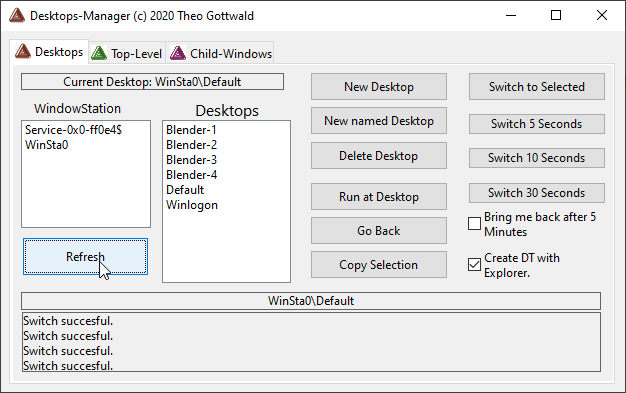

Must say that I have an own tool that is bundled with the Smart-Package-Robot
which has much more functionality (timed switch, unlimited desktops, named desktops, close desktops, "Run on desktop" etc.).
See picture below.
However for using Blender the Sysinternals tool is sufficient. Here is a tip for convenience: Put a Blender Icon on your desktop before you switch to the "Private Desktop". Then you can start Blender from that Icon.
