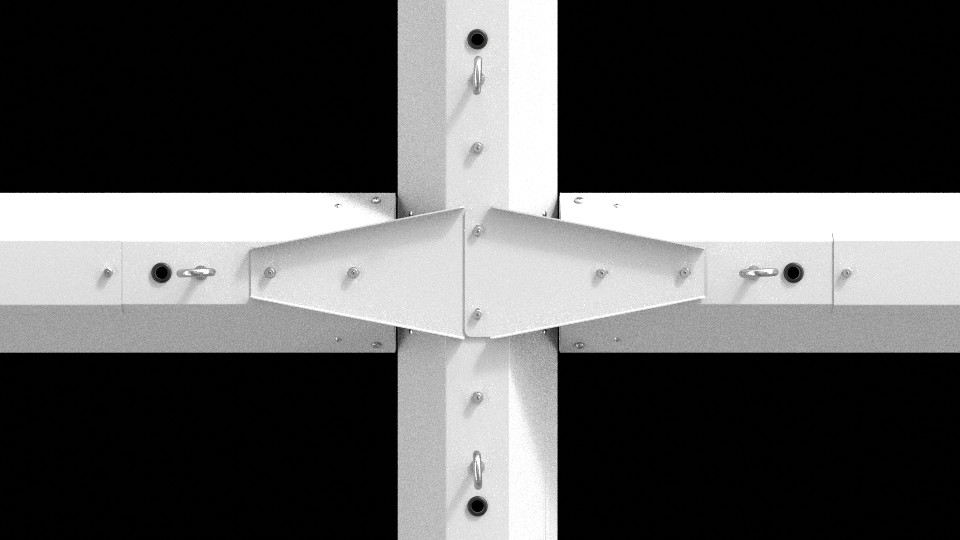

If you switch from CPU to GPU, then artifacts appear.
I know that such artifacts are corrected with Epsilon values.
But, for some reason, I cannot pick them up this time.
Blend file: https://dropmefiles.com/LScwZ

these values do not work for me.
This model is from CAD.
I plan to render a lot of such models in Luxcore. You need to figure it out, to reach the truth.
Yes, if you do a retopo, then the rendering goes without errors.

curious. your scene works for me too.
I will play Sherlock Holmes
Dez!
Posts: 369
Location: Ekaterinburg
Re: Epsilon
Post by Dez! »
KintuX, thank you, you helped.
I found that you moved the camera closer to the subject and used the Clipping options.
This gave me the idea of looking for a problem in the Clipping parameter of the camera.
Having configured it correctly, the problem disappeared.
I would like to draw the attention of the developers.
If you use these scene settings:
then camera Clipping values require tens of thousands of millimeters
It is curious in this moment that the Clipping parameter can be completely disabled for CPU - everything will work flawlessly. But the GPU requires tuning.
