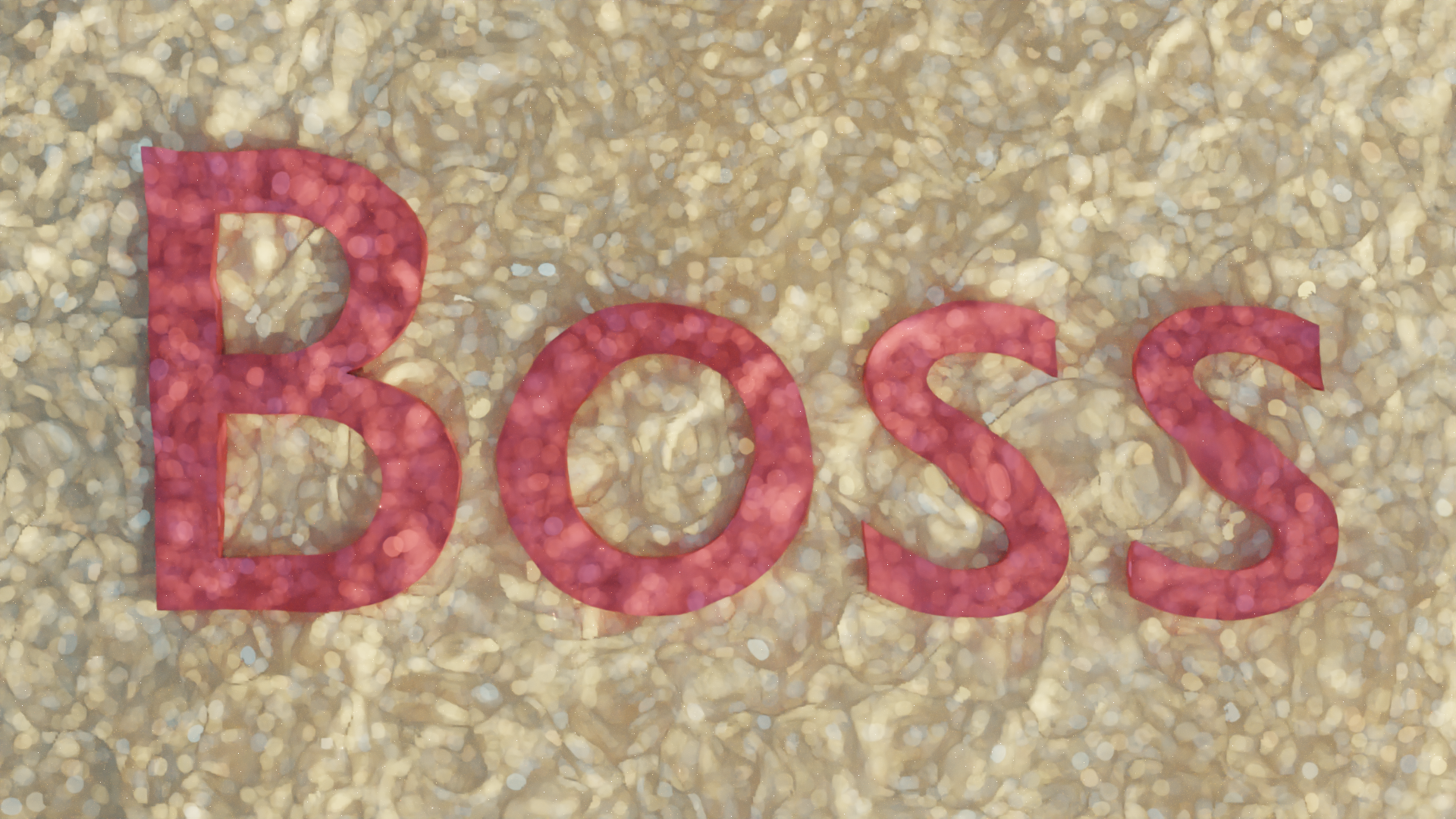

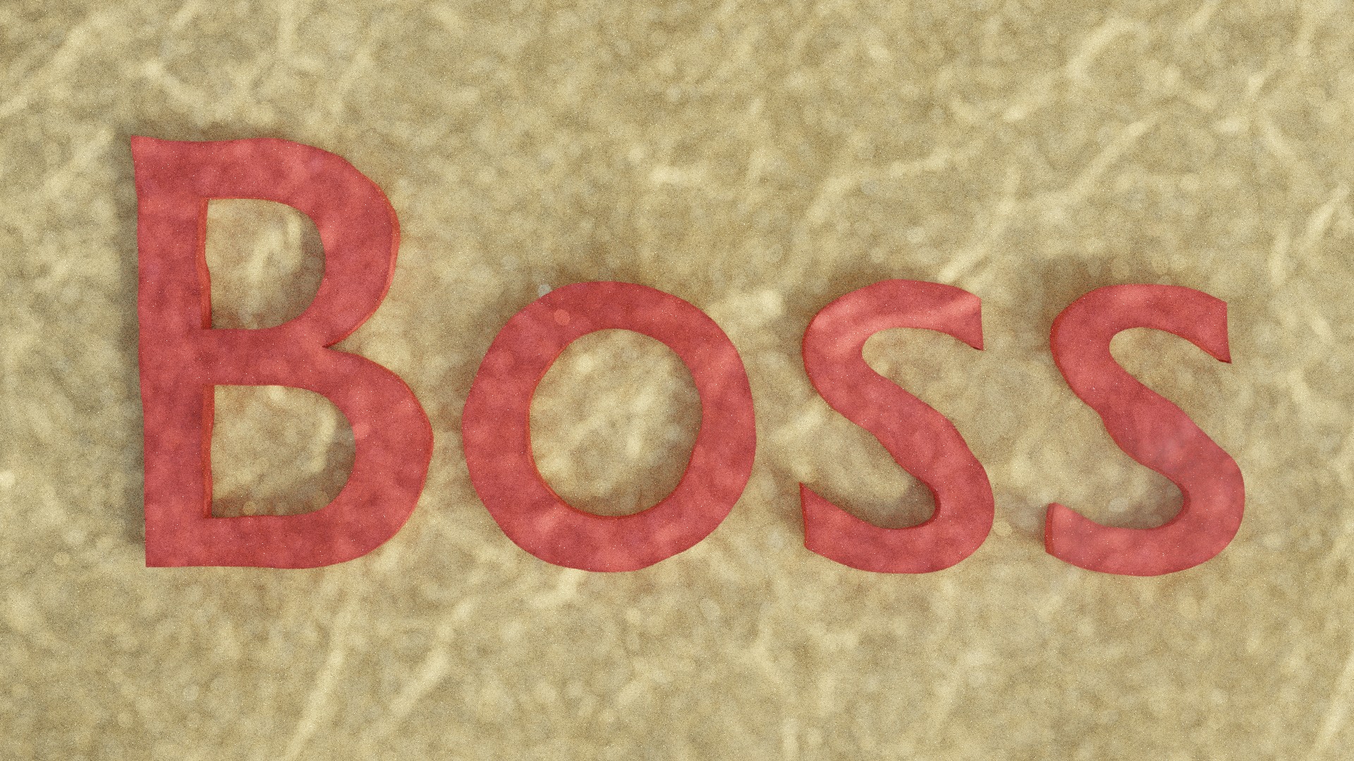

Hi everyone,

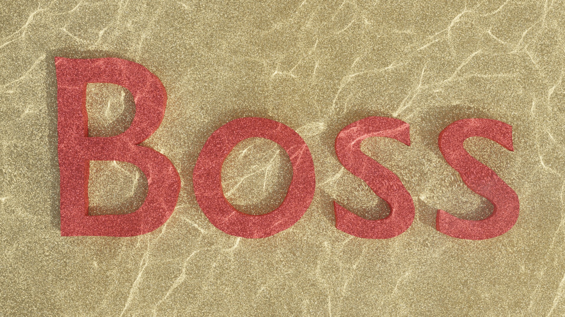

When using path+sobol and phontongi enabled, I get small circles instead of caustics. It only happens when viewed through glass (or water). If I put the camera behind water, caustics will render just fine. Also it works in bidr+metropolis.
I tried changing lookup radius, but I believe it didn't helped much.
Please see attachment for comparisons and more info.

normal
normal
not_normal
not_normal

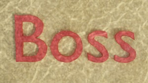

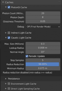

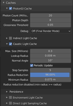

You don't need env. light cache and indirect light cache in this scene.
About the caustics cache, you just need a lower lookup radius (and maybe raise max. size and lower step samples to focus more on the caustics, since they are taking more time to clear than the other noise).

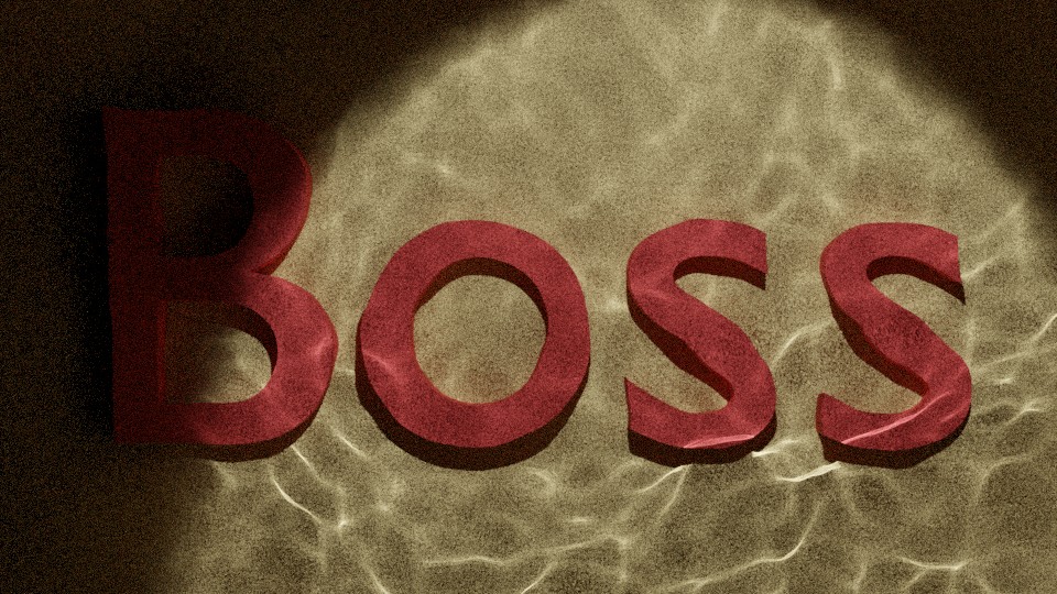

old settings (100 samples)
new settings (100 samples)

While its much more clean, small circles still appear in image, at least compared to bidr+metropolis.
Will they disapear with more samples?
And why does it only happens when seeing through glass?
Again thanks a lot for support!

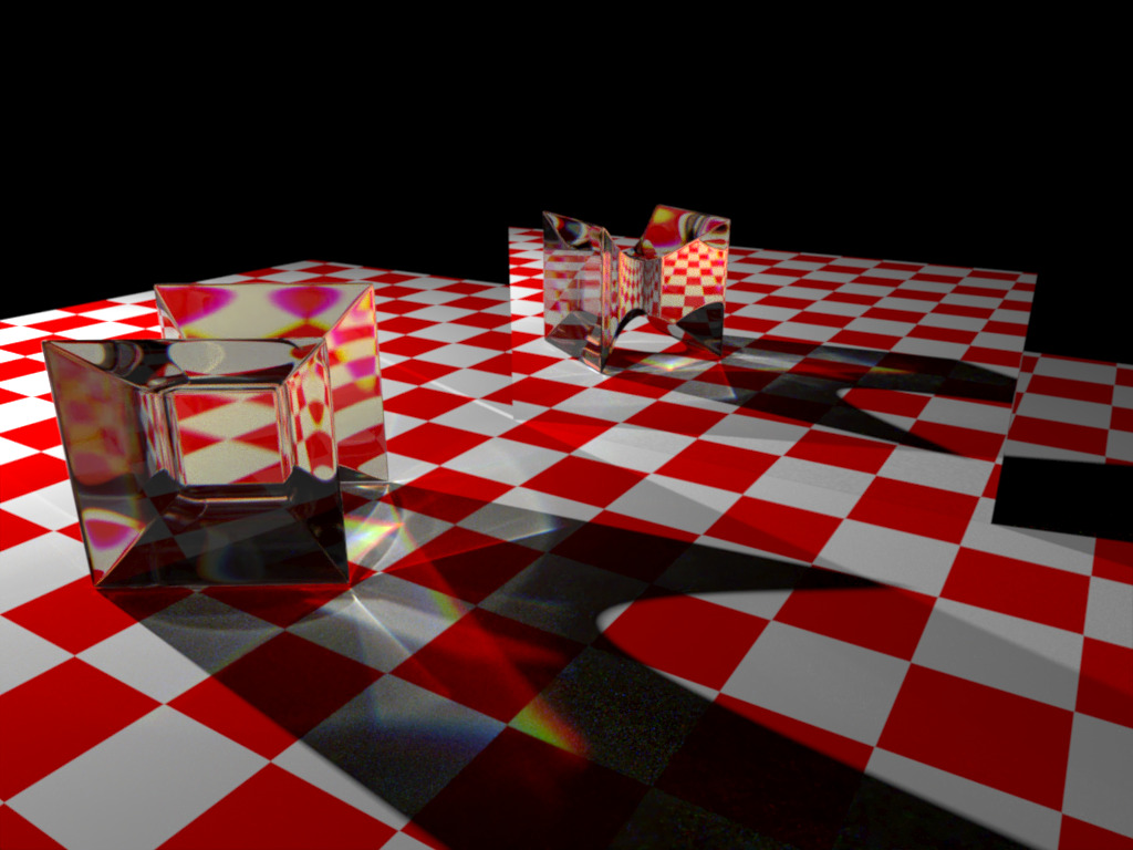

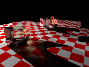

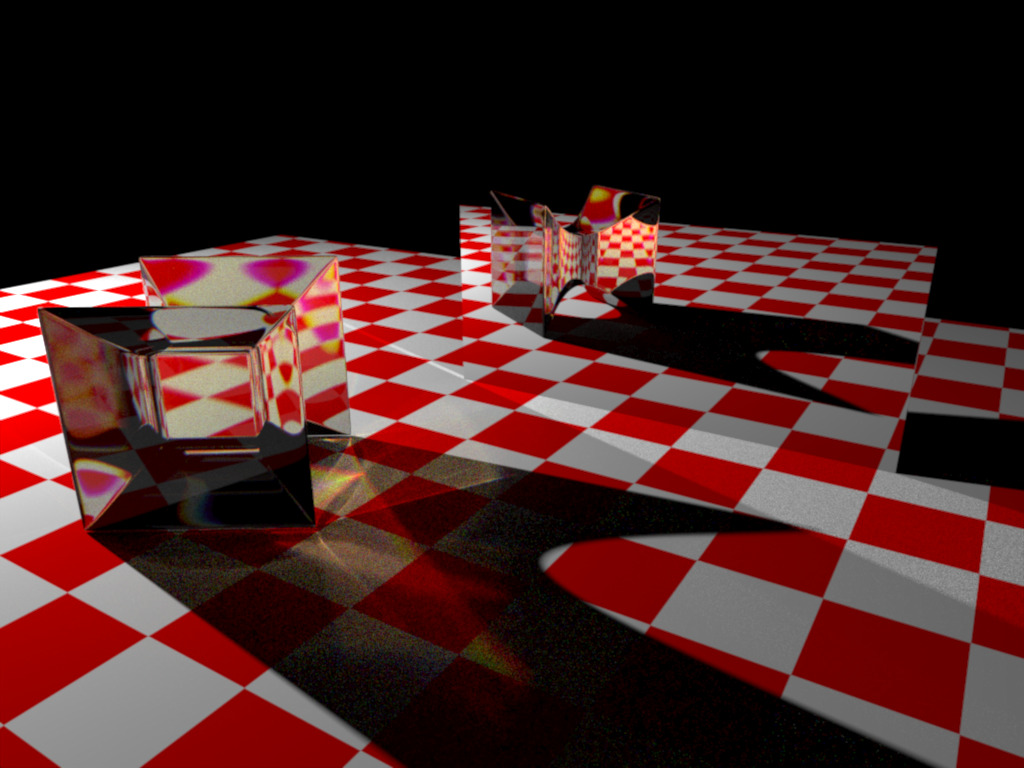

I haven't looked into the scene (have you enabled light tracing ?) but from your description, I was assuming they were SDS paths.
In this test scene, the caustics on the mirror are SDS paths and are visible when using caustic cache:
They are not visible if you use BiDir+Metropolis:

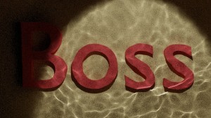

Well I'm not sure if they are SDS caustics, but my scene has the camera above the water, with caustics at the sand (camera is not underwater, but caustics are).
In your example with mirrors, you are saying I can only get the same results using the caustic cache (not using metropolis)?

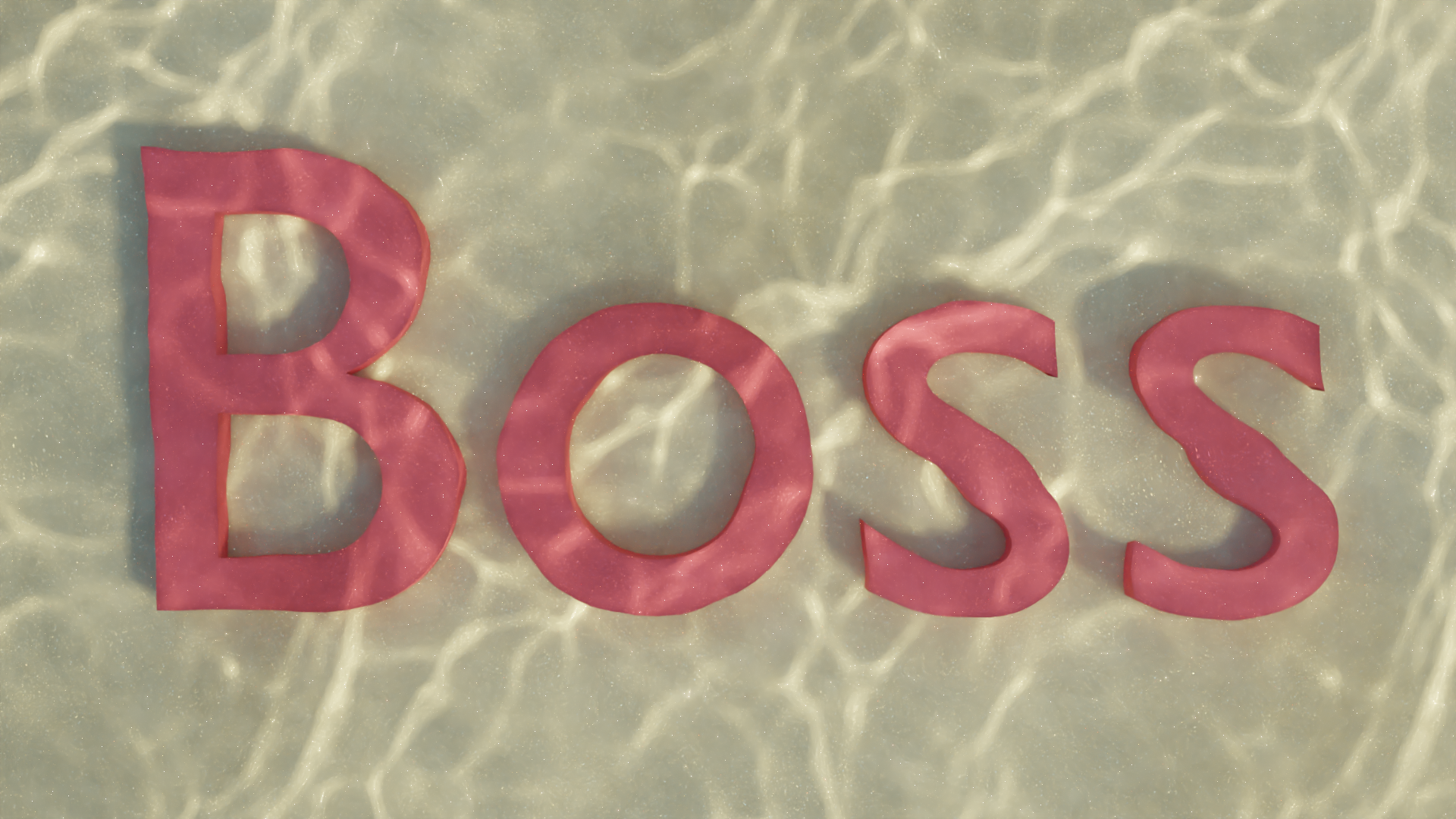

B.Y.O.B. wrote: Sun Oct 04, 2020 10:46 pm About the caustics cache, you just need a lower lookup radius (and maybe raise max. size and lower step samples to focus more on the caustics, since they are taking more time to clear than the other noise).

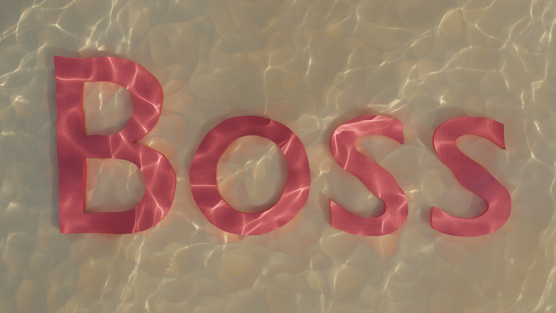

Finally, I did what B.Y.O.B. told me, but in final render caustics are kind of "blurry" (not sharp) compared to BiDir+metropolis, though much better than before:
Thanks everyone for support!

LuxNoob wrote: Mon Oct 05, 2020 1:42 pm Well I'm not sure if they are SDS caustics, but my scene has the camera above the water, with caustics at the sand (camera is not underwater, but caustics are).

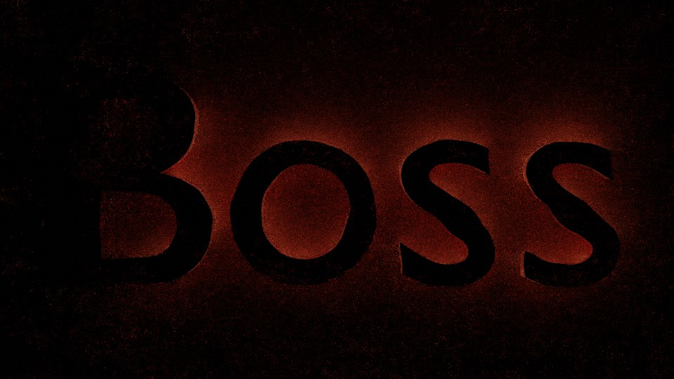

They are SDS caustics, but since the only light in the scene is the environment light with HDRI, Bidir can render them (inefficiently), because environment lights are intersectible (I think). If you would use a non-intersectible light like a point or spot light, Bidir would not be able to render them.
Attached is an example:
test (1)_spot.blend
(878.62 KiB) Downloaded 319 times
bidir
bidir
caustic cache
caustic cache

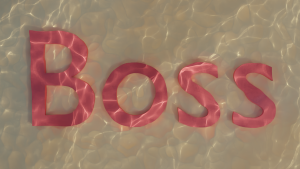

LuxNoob wrote: Mon Oct 05, 2020 1:42 pm Finally, I did what B.Y.O.B. told me, but in final render caustics are kind of "blurry" (not sharp)
Have you tried lowering the radius further?
Unfortunately it is an annoying trial&error process until you have figured out a good radius.
